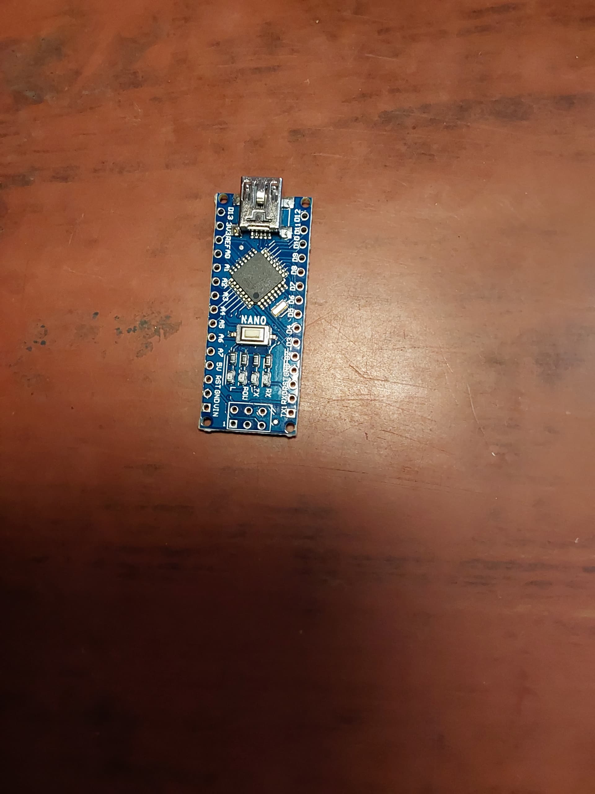

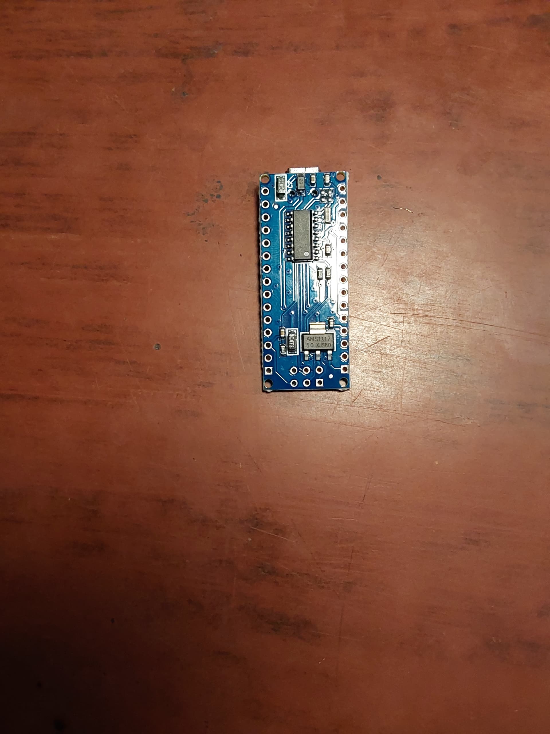

guys isnt this nano. i can clearly see ATMEGA 328P on the micro controller
@sterretje @arduinojanuary @xfpd

Please try this experiment and then report back with the results:
:exclamation: This procedure is not intended to solve the problem. The purpose is to gather more information.
  1. Connect the Arduino board to your computer with a USB cable.
  2. Press and release the button on the Arduino board that is marked "RESET".
Now please reply here on the forum thread with the answers to the following questions:
  • Did you see the LED marked "L" on the board blink immediately after you released the "RESET" button?
  • Did the LED blink only once, or did it blink multiple times quickly immediately after releasing the button?
@ptillisch I have two boards. On one it is blinking, while on other it is not , Still it is not uploading, is it a error withmy uploading cable

I am getting same programmer not responding for both boards.
It is blinking multiple times on one board while not in another.
OK, that is good. The blink after reset eliminates some possible causes of the upload error. We now know two things about the board that blinks:
  • The primary microcontroller on the board is running
  • The bootloader program that handles sketch uploads is present on the microcontroller.
  • You have correctly configured Arduino IDE for use with this board.
This result tells us that one of the following two things is happening on the board that doesn't blink:
  • The microcontroller on the board is not running.
  • The bootloader (a program stored in a special area of memory in the microcontroller that handles sketch uploads) was somehow erased or corrupted.
For now, let's focus our attention exclusively on the board that blinks. Trying to troubleshoot two different boards that apparently have different problems will be sure to cause confusion. Please disconnect the board that doesn't blink from your computer and put it in a drawer until we request you to get it back out again.
This error might be caused by having the wrong port selected from the Tools > Port menu in Arduino IDE.
Please perform this experiment to verify that the port you have selected is your Arduino board:
  1. Disconnect the USB cable of the Arduino board that blinks from your computer.
  2. Select Tools > Port from the Arduino IDE menus.
  3. Take note of the ports (if any) listed in the menu.
  4. Close the Tools menu.
    :exclamation: The ports list is only updated when the Tools menu is re-opened, so this step is essential.
  5. Connect the Arduino board that blinks to your computer with a USB cable.
  6. Select Tools > Port from the Arduino IDE menus. - If a new port is listed in the menu, that is the port of your Arduino board.
If you saw a new port appear at the last step, select that port from the Tools > Port menu and try uploading again.
If this doesn't solve the problem, please reply here on this forum thread with the answers to the following questions:
  • While following those instructions, did you see a port in the Tools > Port menu at step (6) that was not present at step (3)?
  • If you did see a new port, was the upload successful after you selected that port?
@ptillisch
there was listed "COM 3" when board was not connected in GRAY
after connecting, button became clickable and listed only one port "COM 3"
Was the upload successful after you selected that port?
