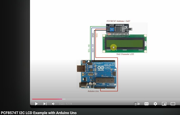

I'm trying to show text on 16x2 LCD screen but no luck.
Connection is very simple (all cables connected and checked)
I checked my address and it is 0x27.
Here is a code:
LiquidCrystal_I2C lcd(0x27, 16,   2);
  lcd.init();
  lcd.backlight();
  lcd.print("TEST");
  delay(10000);
If I remove lcd.backlight(); the LCD blacklight is not turning on. When I put lcd.backlight(); as in the code the blacklight is ON, but I don't see any text there :frowning:
So because of blacklight is working looks like the LCD receives some signals, but not for text...
What can I try also to make it works?
Many thanks

Don't see text but see only blinking of backlight :frowning:
I need to [quote]
rotate Contrast potentiometer on LCD back
[/quote]
