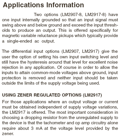

I'm stuck with a 14-pin LM2917 - i've got an 8-pin on order now, but damn it, I want to get this to work.
I've built this on a breadboard using a modified version of GitHub - designer2k2/multidisplay: The MultiDisplay Project, An opensource datalogger, boost controller and display for cars . I have then used the datasheet as well as this schematic to convert to 14 pin... :

If I pulse 14V onto the "Signal In" port with that powersupply also connected to ground... I get... nothing. The sig-in line goes from 5.08V to 5.6V, and there is no signal on "SigOut".
I've played around with a few variations.. but buggered if I can get this to behave.
Further, if I ground the input signal, I get much better voltage response than if I just ground it to positive... yet this should be designed to read the 12V+ lead off of an injector... The idea is it will take "Signal In" from the 12V+ signal from a Fuel Injector, and then should put out a 0-5V Voltage on SigOut to then read on the Arduino as RPM..
Its driving me nuts... and I refuse to admit defeat with just getting an 8-Pin (eventually) and copying the original schematic... Im guessing now (totally) that my 'test powersupply' is putting 70ma across the base of the 557, which is saturating it. so maybe I need to change the 22k's out ??? I dunno.. I feel well past my depth trying to sort this out...
