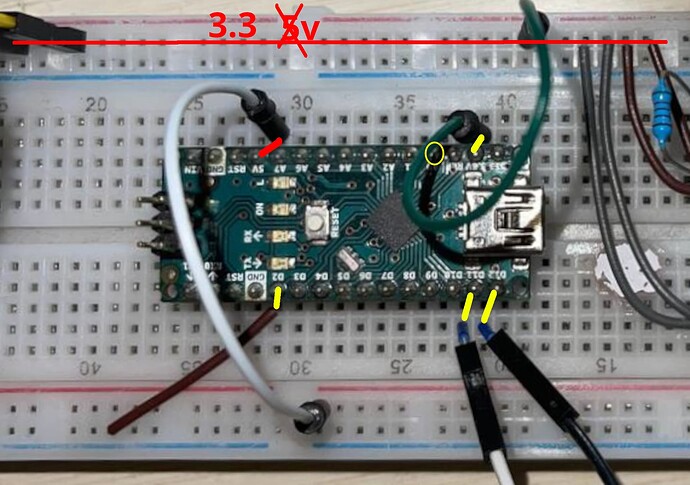

Problem with LORA module E32900T20D with Arduino Nano
Hi guys, I'm trying to setup my LORA module on the Arduino nano using the sketch below from the
"LoRa_E32.h" library but the serial monitor shows the "no response from the device" message. I've checked the wirings but they seems correct. The same scheme works somehow on the Arduino Uno. What am I doing wrong? Thank you in advance.
Below the sketch that I'm using and the scheme.

Your code and wiring do not match.
