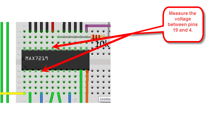

Here is my wiring. Top right I drew what I get when I want to display "1234" (Red = "on", black = "off"). I tested SEVERAL MAX7219. I also tried without the 10k resistor between vcc and Iset

What is the voltage from pin 19 to 4?
between pins 19 and 4 I 4.60v.
