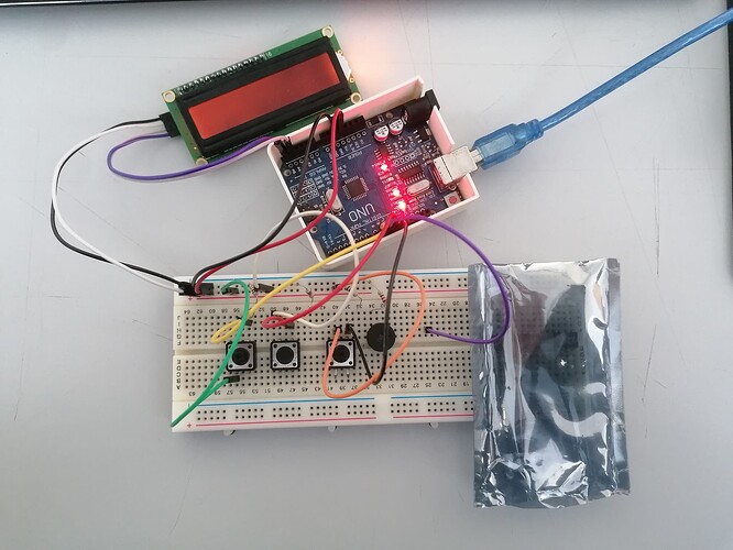

Hello. I have been building a device for a class in college but somehow, the LCD display seems to jump a cursor line at random whenever i input a new letter.
Here is the code:

and here is a picture of the connections:
Hi, @pedro_n00
Welcome to the forum.
Do you have pull-up or pull-down resistors on your buttons?
It sounds like you have your digital input pins that are connected to the buttons open circuit when they are not pressed.
If your buttons got HIGH when pressed, you need a 10K resistor between each of the buttons input pins and gnd.
This will make sure the inputs are LOW when the buttins are not pressed.
As a quick try, you can try changing:
pinMode(buttonMorse,  INPUT);
to:
pinMode(buttonMorse,  INPUT_PULLUP);
That turns on an internal (20k?) resistor as a pull up.
I did take a quick look at your code and couldn't find anything. You may have to do some debugging by putting in some Serial.print statements to watch where the cursor position is. There may also be a command with the LCD that will indicate the exact cursor position.
Sir Michael
buttons are typically connected between the pin and ground, the pin configured as INPUT_PULLUP to use the internal pullup resistor which pulls the pin HIGH and when pressed, the button pulls the pin LOW.
a button press can be recognized by detecting a change in state and becoming LOW and may need to be debounced (e.g. delay (20);)
if you're trying to measure the time that the morse button is pressed, shouldn't it be debounced?

Please say how you buttons are wired.
Please describe the function of the three buttons.
Please say what you are working with for the dot period. It might be nice as you fix this to make the dot period adjustable, even better (but harder) would be to make it adjust itself to your fist.
Then perhaps some more attention, from me anyway.
