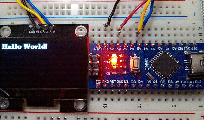

I'm using the oled 1.3" I2C but it doesn't work on the arduino Mega 2560 what could be the problem?
If using the same oled on the arduino nano works, it just doesn't work with the mega.
The example I used was the one provided by the libraria U8G2 "Hello World", I configure oled, but it only works on Nano.
Is it necessary to configure any pins for the Mega?
The constructor statement is the same without any changes for both the Nano and Mega boards.
The only change I make is in the IDE to choose the board.
I made a montage with the image to reduce the size and remain preceptible.

This would solve broken HW SDA, SCL pins.
But I would always be more suspicious of connecting wires/soldering than a factory-made Mega2560.
Regarding headers, shield pins, breadboard, ...
I made a block of 8 LEDs with SIL resistor pack and 8x1 male header. A floating GND wire and male pin.
This means I can test wiring with a pin wiggle / rotate sketch.
It seems that the SDA pin is low, I have to see if there is a problem with the internal pull-up resistors.
I will see the best way to solve the problem now that it is identified.

The diagnostic shows that your MEGA2560 has got broken SDA, SCL pins.
I suggest that you try SW I2C on some different GPIO pins.
SW I2C must have external pullup resistors. They are often already mounted on SH1106 boards.
You can test the SW I2C constructor on your Nano. If ok on the Nano, it should work on the Mega. (use the same GPIO pin numbers for bit-banging SDA, SCL)
