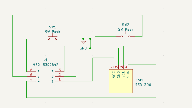

here is the wiring schematic
as you can see the OLED and push buttons are connected to a shield brd which can be seen here.
thanks for your help!

  • Good try on making your schematic but all connections should be obvious; don’t make the viewer guess how things are interconnected.
  • why is 3v3 connected to Aref ?
  • a ceramic 100nF decoupling capacitor from 5v regulator pin 1 to 2 is needed. Close the the regulator.

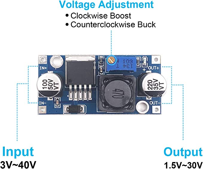

BTW, suggest you use a Buck converter (step down).
Linear regulators for digital circuits might better be switched out to SMPS/Buck converters.
  • Make sure you adjust the output voltage to ~4.9v before connecting to the Nano 5v pin.
About $2.00
