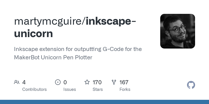

Im making images in Inkscape 0.48.5 (it has to be older one) and makerboat G-code library to generate G-code.
Inkscape works well for a lot of people and fortunately for you you can eliminate bad g-codes if you check out your plugin for generation.

"makerboat" doesn't show me anything useful ?
Again please PLEASE use links where needed !
Any reason for sticking with older inkscape ?
GIMP has many similarities to inkscape and is also used by quite a few people too.
I didn't attach link in the first place because this website doesn't work on pc and it was difficult to find it again but here's extension:

In guide it says to download specifically inkscape 0.48.5 and mentions that it has to be this version, not new one. My guess is that extension linked in guide works only with 0.48.5 version but i'm not sure.
Fact that is n longer maintained would also be a good reason to move along to something else.
Certainly worth looking elsewhere and at other products.
Maybe a different plugin that does the same thing but is newer.
Realise you are new to this but it is something I had to get to grips with when starting out generating g-code and found a lot of the inkscape plugins were quirky when I started out which was the main reason I went through a few different solutions until I settled in for ease of use and speed.
