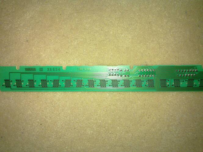

I am using the keys from my old piano (Yamaha PSR-75) as the internal circuitry does not work anymore and i would like to recreate the piano. The problem that i am having with doing this is the way that the keys are wired. There are 49 keys on the board but only 15 pins coming out. I have traced how each key is handled and it uses a combination of the pins to complete a circuit. The last 6 pins from the ribbon are a positive input (diodes on the board ensure this) and go through to the first 9 pins to make a set of 9 lots of 6 (54) so that all of the keys can be measured. This is where the problem lies: i can easily get a single or one set of inputs through the board but it has to go to the ground pin on the arduino. I cannot find a way to read a negative current from the arduino input pins to tell the combination of which positive and negative pins on the keyboard are closed.
I have uploaded pictures of the input board below (sorry for size), i have also given an example of the key mappings below

The keys on this device would be connected just like those on a 4 x 3 keypad.
http://www.arduino.cc/playground/Code/Keypad
The only difference is that yours is a 9 x 6 keypad, so you have more rows and columns.
The keys are read by rapidly cycling through the row/column combinations to see when current flows (i.e. a key is pressed).
