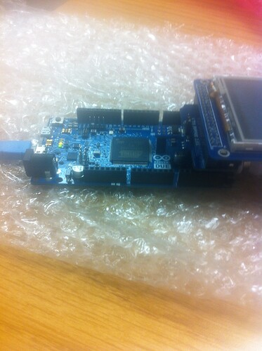

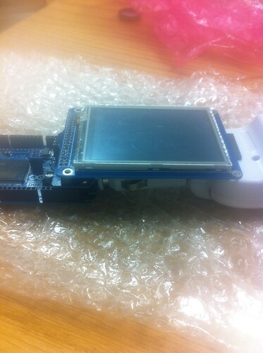

My senior project team and I are working to display words on the TFT_320QVT screen, with the eventual goal of displaying waveforms.
The hardware we're using consists of the following:
Arduino Due R3 (http://arduino.cc/en/Main/arduinoBoardDue)
Sainsmart TFT_320QVT and TFT Shield V2.1 (http://www.elechouse.com/elechouse/index.php?main_page=product_info&cPath=148_211&products_id=2217)

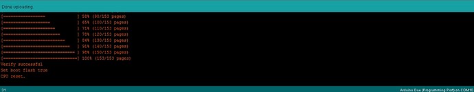

We're beginners so please bear with us. The screen backlight is on, but whenever we upload the code it doesn't output the words onto the screen. Still, the code compiles without any errors.
Do you have any advice on how to make the words actually appear on the screen?

I think I know what the problem is.
I think you are using a SPI interface and you have not redefined your pins for the DUE.
There is a post about this where the guy discovered he should be using pins 75 & 76 instead of the other
pins used on a Mega because on the DUE the only SPI pins are on the 6-pin SPI connector in the center
of the DUE. There are not brought out to the shield pins. I will find the post and get back to you
later but I think that is your problem, unless you can tell us you are already aware of that.

Look for the 6-pin SPI connector (see attached).

Hey guys,
Is this any help ?
see attached.
NOTE THE WIRE CONNECTIONS TO 6-PIN SPI CONNECTOR IN MIDDLE OF BOARD.
Sound familiar ? (the same one I mentioned)
If I'm not mistaken you don't have anything connected to the 6-pin SPI connector at the moment ?
 UTFT myGLCD (ITDB32S,[b]38,39,40,41[/b]); // Remember to change the model parameter to suit your display module!
If you don't mind me asking , what DUE pins are you currently using and why are the only ones mentioned for the display ?
What other pins are you connecting for communication with the TFT ?
On an Arduino UNO those pins on the ISP connector are brought out to D10,11,12,& 13.
If you have a "SHIELD" plugged into it then you don't have too many options.
It is either compatible or you have to distance yourself from DUE (literally, that is physically).
If you insert MALE:FEMALE headers as spacers then you can cut the ones you don't want connected and run the wires
some other way, like from a 6-pin connector plugged into your ISP connector to the pins on your shield , that have the
pins cut on their spacer headers so the wires soldered to TFT pins will be the only connection.
There is no reason why it shouldn't work, but at most your talking about 6 pins that have to be rerouted.
Anyone would look at it and probably not even notice that the cable on top is soldered at the other end
of the ribbon cable at the TFT bd.

So the bottom of the shield has the female connector to mate with 6-pin SPIN connector I mentioned in the photo ?
Then it should work. That's strange.
Does your display work with the libraries from elechouse.com? Once this is known to work, it is easier to move to UTFT.
Oliver
Edit: Looking at the tech docs, it seems that the SPI (6-pin-header) is only used for the SD card.
Zoom in on the right half of the attached photo of the DUE and you will see THAT 6-pin connector is
silk-screen labeled "SPI". (the one I mentioned in one of my first replies). If you zoom in on the OTHER
photo you will see that the TFT has a little narrow "handle" part that has a mating connector for the
SPI connector. So as far as I can tell, the TFT was designed to utilize that connector but not obstruct
everything else on the board you might want to use, like all the other shields that plug into the top
of an UNO, look like they will still fit. The display should work. I'm puzzled too.
