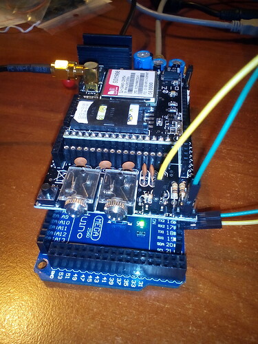

See What can I do against this error? - Programming Questions - Arduino Forum.
The solution is to change line 55 in HWSerial.cpp to:
const char PROGMEM *p = (const char PROGMEM *)ifsh;
Then it will compile.
Also don't forget to bridge the TX / RX pins (remove the jumbers and use the middle pin of TX and the middle of RX) of the GSM board with pins 18 / 19 of arduino MEGA. See the image in the attachment.
