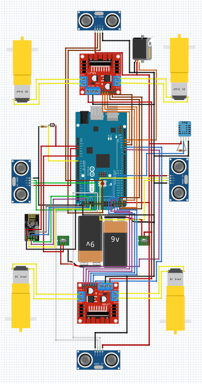

I have built a (mechanum wheel) car with 4 yellow DC-Motors. The problem i have is, that if i want to drive the motors, they wont spin everytime. Here are some scenarios where it works and where it doenst work:
-all 4 motors forward or backward: works
-the right two forward and the left two backward and vice versa: works
-the top right one and the left bottom one foward: no motor spins
-the top left one and the bottom right one forward: only the top left one spins
You can see which motors i mean when looking at the wiring diagram:
It has to do something with the electrical wiring, as the code runs the motors the same in every scenario, it just tells them to spin or not to spin.
Heres how the car is built up, the motor drivers sit under the Arduino Mega:
I would appreciate it if anyone could help me to solve this issue, Thanks!
Hi, @guter123
Welcome to the forum.
It sounds like your 9V batteries are not able to power ALL your vehicle.
Those batteries are designed for much lower current loads than your car.
If you lift the car off the ground and let the motors run with no load, what result do you get?
Do you have a DMM? Digital MultiMeter?
Thanks... Tom... :grinning: :+1: :coffee: :australia:
@TomGeorge As I said, if I run all 4 motors simultaneously, it works as expected. Only in some special scenarios, the motors won't spin. And if I lift the car, the result is the same.
And yes, I have a multimeter :slight_smile:
And the 9V batteries are rechargeable and are able to deliver more current than the normal ones
Post your code, using code tags.

@TomGeorge So if I only want to control one motor of every driver, only motor A works, the rest doesn´t want to move
How much voltage and current do your motors want to consume?
Measure the voltage arriving at the motors.
Why do you make these local variables, only here?
@DrDiettrich I have a potentiometer that controls the motor speeds, so I measured a range of 3.2V (lowest speed) - 5.5V (highest speed), but that's also due to the batteries not being charged fully up (7.5V, I will recharge them now, but I also tested it with fully charged batteries and it didn't work in every case as well).
The variables are local because they are different than the other ones on top of the switch-statement, they control different motor pairs. Its a thing of the mechanum wheels in order to let the car drive sideways.
Is that the rated motor voltage?
You know that the L29x drivers drop up to 4V and are inappropriate for battery operation?
May be, but thats obviously not the problem here, as the motors all spin if they are told to do so. But they dont work if every motor driver only has to run one motor.
@DrDiettrich @TomGeorge I ran another test where i wanted to drive each motor independently. With the front two motors (A and B), this works very well, but the rear ones (C and D) have issues. The problem is described in the comment:

  analogWrite(MOTOR_C_EN, 255); //if this is commented, motor D wont spin, if this is uncommented, motor D will spin
  analogWrite(MOTOR_D_EN, 255);
  digitalWrite(MOTOR_D_IN1, HIGH);
  digitalWrite(MOTOR_D_IN2, LOW);
So in general, if you want to drive one of the rear motors, you have to enabled both motor pins, even if only one motor should spin.
Could this be a faulty motor driver or is there another solution I didnt thought about?
I changed the pins in the code a bit again and now it surprisingly works as expected. But thanks for all your ideas!
