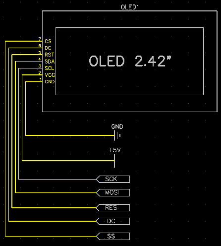

First of all, let me say, I am new here, from Spain. I am working on my university final project wich is an OBD2 diagnostic tool, with an ATmega32U4 (Arduino Micro) and a STN1110 OBD2 controller.
I am trying to getting image on my OLED Display, it worked before with other pins I don´t remember, and now I am trying again on the PCB I made. This means the pins are not changeable.
I think the best thing I can do is to post the code and the schematic part of the ATmega32U4 and the OLED. So here we go...

The correspondent part of schematic are attached as picture.
And now the issue:
On the protoboard using another pins (I dont remember which ones) it worked. But I still use MOSI and SCK pins, for the other ones, RES, DC, and SS can be used normal digital pins (as I have learned before designign the pcb).
Now with the pin constructor as in the sketch, when I upload the sketch OR reset the ATmega, it shows image on the OLED for an half second... If I disconnect and reconnect the PCB to the USB is does the next thing:
-On connection the PC does the "usb device connected sound", and then noting on the OLED.
But when I reset with the RST button I have on the PCB it does this:
-On pressing button, "usb device disconected sound", when releasing, "usb device connected sound".
-After a few seconds, 7 or 8, again "usb device DISCONNECTED sound" on my laptop, and during this the OLED shows the text for a half second and turns it again off.
Really, it´s weird, I tried all kind of things, I checked the pin assignation on the constructor, and it must be correct.
Any idea?
