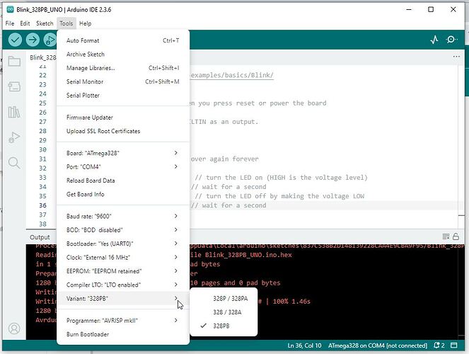

Here is the text after setting baud rate to 9600:
Avrdude version 8.0-arduino.1

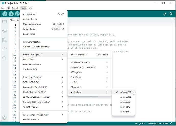

If I change the baud rate to 19200 it works again.
If I change baud rate to "Default" it fails.
I tried changing baud rates again and the only two that work are 19200 and 9600.

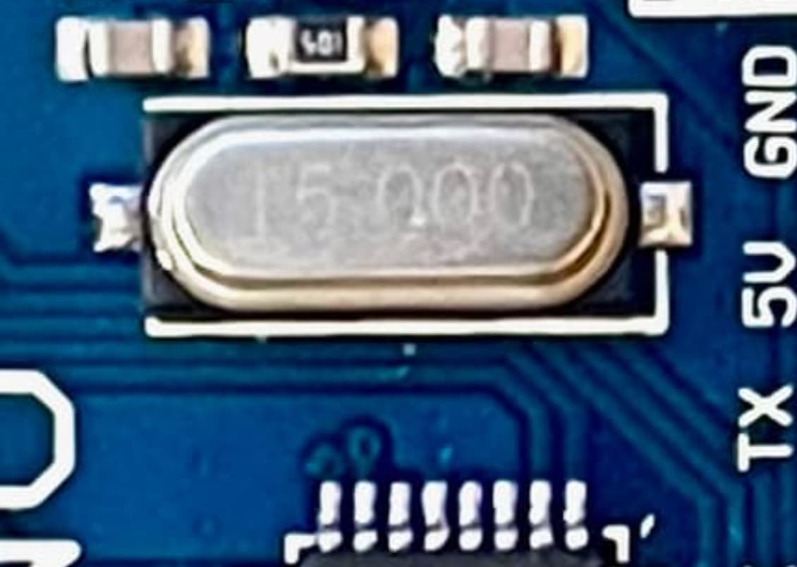

Is it a defect in the image or is the ATmega crystal marked as if it were 15MHz instead of 16?
Sharp eye and good find. Urboot and CH340G must be doing the job of compensating for the incorrect baud rate. I’m amazed it’s working at all.
Wow, That's sloppy! I can't believe they are selling them like this.

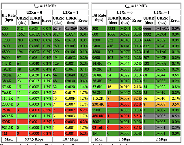

The AVR itself can work well with 115200 baud at 15 MHz, see tables below. But the beauty is Urboot's auto baud detection logic. It will always try to use the best UBRR value to get as little error as possible, regardless of the. In fact, MiniCore loads the same (UART0/UART1) pre-compiled bootloader hex file for the 328PB regardless of which oscillator option you're using. The only reason why the oscillator option is there is to set the correct fuse bits and get the timing (delay(), millis(), micros(), etc) right. But Urboot "doesn't care" about the actual clock speed because of the auto baud rate detection it utilizes every time you upload something.
Just an update, with better picture it's apparent that the crystal is 16 MHz.
Thanks for all the help getting these 328PB UNO clones working.
The picture in post #3 shows the crystal is labeled 15000 with the text oriented so that the bottom of the numbers faces toward the MCU. This better picture shows 16000 with the text oriented so that the top of the numbers faces toward the MCU. So that is a different board.
I bought 4 of these and I can assure you that all four have 16 MHz crystals. One crystal is rotated 180° from the other 3 but the orientation is not important.

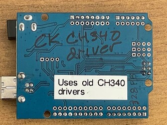

And, I just noticed this sticker on the bottom of one of the boards.
Funny thing is, apparently when I bought these 3 years ago, I figured out that I needed to load the "OLD" CH340 drivers :frowning:
