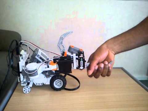

I have two (continuous rotation) hobby servo motors connected in parallel on a breadboard, and these are powered using the regulated 5v from the arduino.
The problem I'm having is simple but I'm not sure how to correct it...
  1. When i supply the Vin pin on the arduino with 5v (using the green wire) from a lego nxt brick port, the servo motors start to move on their own accord even if the arduino program hasn't told them to.
  2. When I supply the arduino with 9v from a lego nxt brick port, the servo's remain in position like they are supposed to, but one of them doesn't work when the arduino program tells it to move.
  3. When I supply the arduino with 5v via the usb connection port, everything works with no problems... the motors stay in position until the arduino program tells them to move.
However I do not want the robot tethered to the computer hence I would prefer if I could get it to work using either the 5v or 9v supply from the nxt brick, could anyone help with this?
Here are videos of the robot working as it should (using usb power to the arduino).
http://www.youtube.com/watch?v=7wd0dvZ45pA http://www.youtube.com/watch?v=VUmcQx05n9w
Thanks a lot for any help you can give.
It's more than the Arduino onboard 5V can provide, you're kicking its butt. Make a separate supply for the servos to run from.
I agree with Runaway Pancake, but to be more specific, the Arduino 5v regulator can only supply 800ma (according to the datasheet). Many servos can pull 1.5A or more. You should also use a better 5v supply, as well as a fairly nice size capacitor on the power rails of the 5v supply (servos can be extremely noisy).

Well, that makes sense then. The NXT sensor port pin 1 can only provide about 20ma, so you are way over-loading it. Hopefully you didn't burn out the transistor.
And about it working with USB... USB devices are usually allowed to pull 500 ma (IIRC), and up to 1A if properly configured.

So... I guess for now the easiest thing to try would be to power the motors from a separate supply e.g. a 9v battery.
Here is the datasheet. Scroll down to the 5v one (1117 5.0).
Did you read my second to last reply? I said that the NXT can only supply 20 ma the way you are getting it. That is no where near enough!
Yes, a separate supply should solve the problem.
