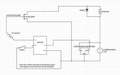

Have you got the FET wired up right? IRLZ44N is an N-type MOSFET, best used as a switch to ground rather than switch to power.
So you connect your circuit with power and where it goes to ground, the FET goes between circuit and ground.
The circuit connects to the FET Drain, it drains current from the circuit and you connect the FET Source to ground. In through Drain, out through Source, down to ground low-side switching.
I used 5V to switch 12V through 12V G4 led discs with IRLZ44N FETs, much less and they would not have lit.

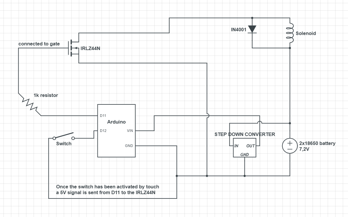

I don't really know how to post an editable schematic sorry, but here's the correct one.

Right now I've made it so I'm sending a high(5V) voltage to gate in order activate it and the drain is connected to the solenoid, source connected to battery ground. Trying to switch Drain and source around allows 08.22V through but I can't use my switch to change the voltage.
Can you post the code you are using for the post #23 test thanks.
Can you measure the voltage at the button input pin of the NANO when you press and release the button, and measure the voltage ar the gate of the MOSFET when you press and release the button?

Oh, you might like this, I connected the IRLZ44N gate directly or through no more than 220 ohms to the IO pin.
I know that I connected 2N7777 directly before after web surfing 2N7777 circuits but I can't say 100% now (breadboard disassembled long ago) that IRLZ44N gate direct to pin is safe. I had spent time reading up on those too. Then I wired 220R or direct and it worked.
The FET should switch full ON by 2.0V. I don't see why 1KR between pin and gate should not work but try 220R?
What is your stepdown converter?
If it is 5V output, it should be connected to 5V pin of the NANO, not Vin.
Tom.. :slight_smile:
The Nano needs at least 4.5V to keep running.

Okay I found some very strange results.. So I took my multimeter and connected it to the ground of the arduino nano, while having the positive(red wire) on the digital pin 11. My multimeter says that there's 1.6V..
Artonn:
Is that with the button pressed?
Can you measure the voltage at the button pin12 on the Nano with respect to gnd, with and without the button pressed.
TomGeorge:
Hi Tom, testing the BTN now. I've removed the switch, because for some reason it stopped working and I think it somehow killed my Arduino because it kind of acted strangely as well.. Luckily I have spare Arduino and I'm not using the switch untill I understand it better.
The new button sends in 4.8V to the Arduino. wow.. Now i get 4.8V out of D11 as well! Alright just put everything back together and it works!
But... I have to remove the diode I've put on for the solenoid, that's super weird. It doesn't work whenever i have a diode on it.
EDIT:
Oh shit, just tested it some more and the diode emitted a little smoke/vapor. It's hot.
The Cathode end of the diode, the end with the white band goes to the positive side of the solenoid, and the other end of the diode to the negative end of the solenoid.
