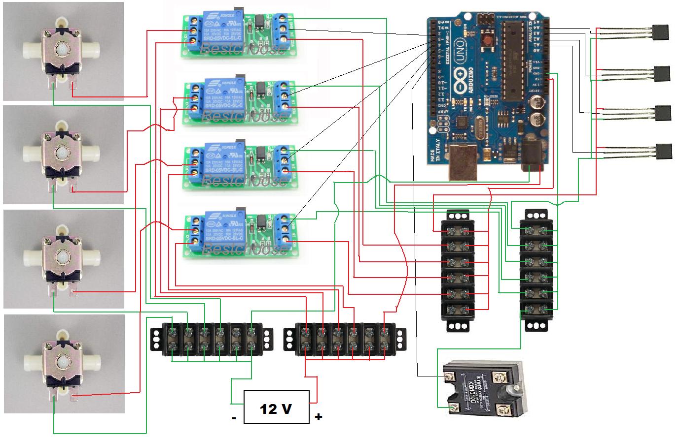

Oh I didn't realize they were electro mechanical. Makes sense. Thanks for all the fast replies. You have been amazingly helpful.
So, do you see any problems with my super ghetto MS paint Schematic attached?
Looks good to me.

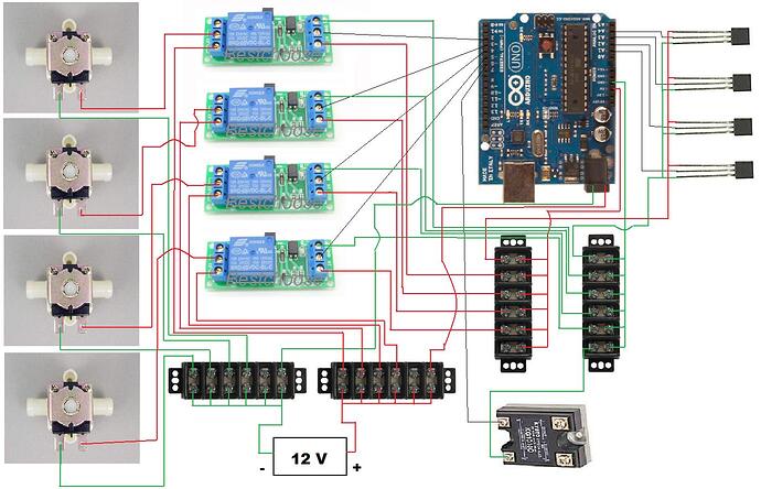

Ok,
So I have everything wired up and working, however I am having some issues with my temperaure sensors. I have attached a full wiring schematic which looks pretty much exactly like my actual panel.
Red = Hot
Black = Signal
Green = Neutral/Ground
Like I said, everything works, however I am getting some strange noise in my temp sensors.
They work perfectly fine in the begining, all of them reading like 68 degrees.
Now there are two times when things go bad.
  1. When I trip a relay and a Valve is opened. If I unhook the vavles, things remain ok.
  2. when I let it sit for a long time doing nothing. Everything starts out fine, temp sensors reading true temps, then after a random amount of time, any where from 5 minutes to 4 hours, temp readings are all over the place.
So when things go bad, the sensors just start reading crazy temps anywhere from like 40 to 110 degrees in ambient air (appox. 68 degrees). After things go crazy, they never go back to normal until I unplug the arduino. When I plug it back in the sensors read correct temps, until I either open a valve or after some random amount of time goes by.
Other things of interest: Temp Sensors are LM34CAZ and I have check the voltages from power supplys and they are dead stable.
Any help is highly appreciated.
Thanks,
Craig
1 has the faint smell of power issues, but hard to be sure - does the system settle down if you turn the solenoid off again?
2 says software. Please post your code.
