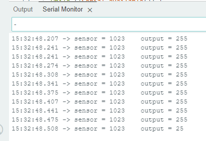

Here is what I'm getting through serial port:
1
2
3
I have this data (which react to movement of left joystick on up/down movement) until I'm trying to load new sketch. At this moment serial port looses connection.

UPD: The sketches are also not loading onto the second Arduino. The eternal inscription "Uploading" and nothing. Apparently this is the first stage that needs to be fixed. I'm surprised by this behavior because I've previously loaded programs onto the Arduino Uno and didn't have any problems with it.
You are not going to be able to do anything until you can upload code to the Arduinos
If you cannot upload a sketch to the Arduino then the Serial output that you see is not from the sketch that you are trying to upload, rather it is from the sketch already on the Arduino. This could be the same sketch but you don't know if it is or not
When you plug the Arduino into USB on the PC is it recognised and is a new COM port created ?
Yes, USB-SERIAL CH340 (COM5)

1
This is the board and it's current status. If I'm trying to upload sketch then it uploads forever. Also: this boards came unsoldered, so this soldering on the sides it's my work. Could my soldering affect their work?
Do you know what the problem is?
No, but you have not posted the output that you get when you are uploading a sketch. What you have posted is the Serial monitor output
Judging by the message
the IDE is using the Serial port at this time, which is what is expected. Please click on the Output tab rather than the Serial monitor tab so that we can see what is going on
Hello, I found a problem: I needed to select an old bootloader for the sketches to start uploading. I have already tested the joysticks, they work. I will test the nRF now, I won't close this topic in case I have any problems.
You would most likely have had a solution hours ago if you had posted the output as requested but good luck going forward
There wasn't any output, there was just "Uploading" message as shown on screenshot. I opened Serial Port because in "output" console there wasn't anything, literally.
