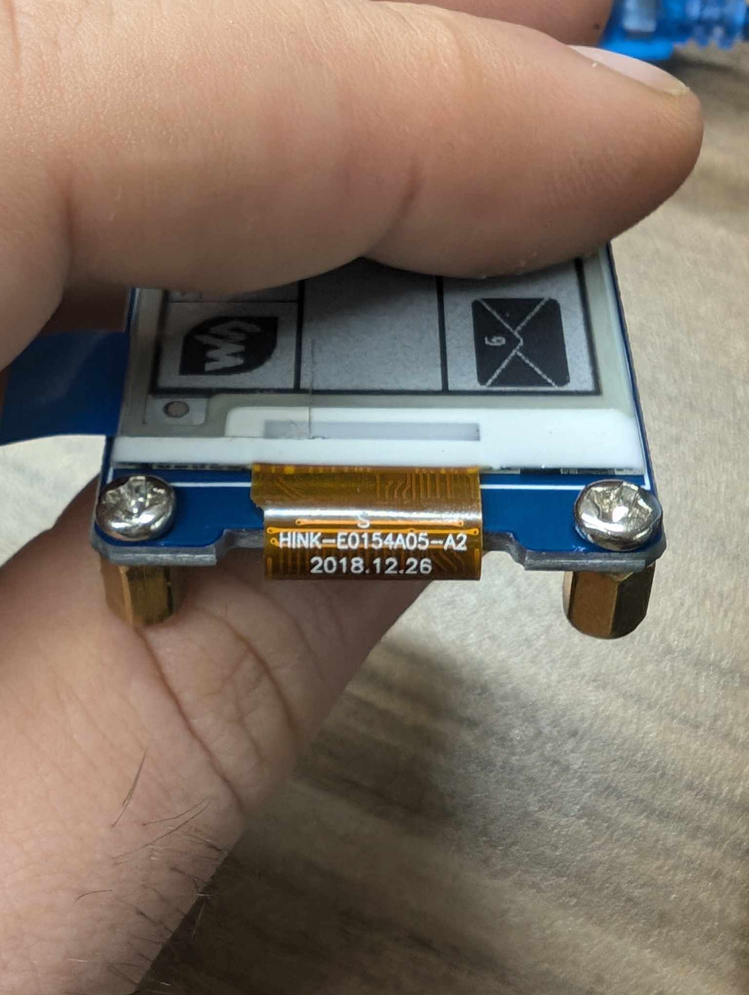

I'm attempting to use a Waveshare 1.54" LCD with my generic-brand Arduino Uno. I successfully connected and implemented the Waveshare demo code to test the hardware, but GxEPD2_HelloWorld.ino just isn't working. It compiles and returns data, but the display shows nothing.
Another discussion indicated that I probably have a GDEP015OC1 display. It is attached as shown:

See GxEPD2_display_selection_new_style.h:
//#define GxEPD2_DRIVER_CLASS GxEPD2_150_BN  // DEPG0150BN 200x200, SSD1681, (FPC8101), TTGO T5 V2.4.1
//#define GxEPD2_DRIVER_CLASS GxEPD2_154     // GDEP015OC1  200x200, IL3829, (WFC0000CZ07), no longer available
//#define GxEPD2_DRIVER_CLASS GxEPD2_154_D67 // GDEH0154D67 200x200, SSD1681, (HINK-E154A07-A1)
//#define GxEPD2_DRIVER_CLASS GxEPD2_154_T8  // GDEW0154T8  152x152, UC8151 (IL0373), (WFT0154CZ17)
//#define GxEPD2_DRIVER_CLASS GxEPD2_154_M09 // GDEW0154M09 200x200, JD79653A, (WFT0154CZB3)
//#define GxEPD2_DRIVER_CLASS GxEPD2_154_M10 // GDEW0154M10 152x152, UC8151D, (WFT0154CZ17)
//#define GxEPD2_DRIVER_CLASS GxEPD2_154_GDEY0154D67 // GDEY0154D67 200x200, SSD1681, (FPC-B001 20.05.21)
and compare the inking on the flexible connector.
Most likely you have a DEPG0150BN, if it is an actual Waveshare board.
My flexible connector:
I tried uncommenting the line for DEPG0150BN and nothing happened. Same for
which seemed to be the closest.
Also, after adding GxEPD2_display_selection_new_style.h, I get nothing in the terminal, which is odd.
Do you think I have a knockoff? It works with the Waveshare sample software.
I took a look at https://github.com/waveshareteam/e-Paper/blob/master/Arduino/epd1in54_V2/epd1in54_V2.cpp
In there I see they use one waveform table for full refresh and one for partial refresh.
The format is for a SSD controller.
GxEPD2 has one driver class with two waveform tables: https://github.com/ZinggJM/GxEPD2/blob/master/src/epd/GxEPD2_154.cpp
but these tables are much smaller.
So it looks like Waveshare now uses a recent panel and controller version, but without waveform tables in OTP. There is no support for it in GxEPD2.

The 1.54" b/w e-paper module I ordered from the Waveshare shop on AliExpress has arrived.
Ordered from from here: https://www.aliexpress.com/item/1005002324111354.html.
The board has a V2 sticker on it, and the inking on the flexible connector of the panel reads
FPC-B001 20.05.21.
It is the same inking as found on my GDEY0154D67 I have from Good Display.
And it works with my driver class GxEPD2_154_GDEY0154D67.
This means the controller of the panel has its OTP programmed with waveform tables for full and for partial refresh.
I have no idea how many Waveshare boards with panels with inking HINK-E0154A05-A2 2018.12.26 have been produced (by Waveshare or cloners), and how many of them have no waveform tables in OTP. But obviously there have been, indicated by the update on their demo code version for V2.
As I don't have this (interim?) version, there will be no support for it in GxEPD2.
