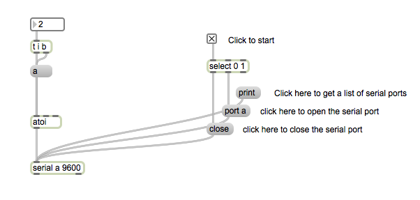

Hi, Thank you for your response¡
Forget about Processing, now I´m trying to send one unique value from Max/MSP to Arduino by Serial; and then in Arduino parse them to the servos and delay them properly.
I´m starting from Communication examples; the part I don´t understand is about encoding data, Max sends an integer but Arduino gets a Byte... from the example I started encoded the entering values from 0 to 9; mapping these values to 0 to 180 (properly for servos) I get so small range. I Tried to amplify the proper range but they stop moving...
It´s a little smart iniciation, at least they move, but I need to control the degrees more properly, any ideas?
Thank you, and sorry, I´m pasting the code fine, n00b issues¡

Is there no way to turn this stuff:
<pre><code>
----------begin_max5_patcher----------
735.3ocyX0sjZBCF8Z3oHCWa2IADT5cc5iQmN6DfrZ1ERXHws1ty9t27Cfnq
PfWE4UZS+Cc0i16t+Eva1evC
-----------end_max5_patcher-----------
</code></pre>
into something readable by humans, so that we can see how you are sending data?
It´s Max/MSP compressed code, it look like this:
Ok. Well maybe someone that knows Max/MSP will come along.
Is Max sending that integer in binary or as text? If it sends 22 as a binary value, then the Arduino can receive that 2 byte value as a single byte (unless you are trying to dealt with servos that rotate more than 255 degrees) with no problem.
If Max is sending "22", then you need to fix what Max is sending, so the Arduino knows where the value ends. Otherwise, the Arduino has to deal with something like this:
IfMaxissending"22",thenyouneedtofixwhatMaxissending,sotheArduinoknowswherethevalueends.
Much harder, no?
I don't understand this statement. The range stays 0 to 180, if you mapped stuff correctly. The resolution goes to hell, since your step size is now 20 degrees.
Since the map function you are using has as it's from range '0' and '9', I think it is obvious that Max is NOT sending binary data.
So, you need to make Max send something after the value (like we use spaces between words), so the Arduino can read and store any serial data that arrives, until the separator arrives, at which time it can use atoi() to convert the string "114" to an int, 114) and then move the servo(s).
Max could even send something like "2:109!" to tell the Arduino to move servo 2 to 109 degrees.
