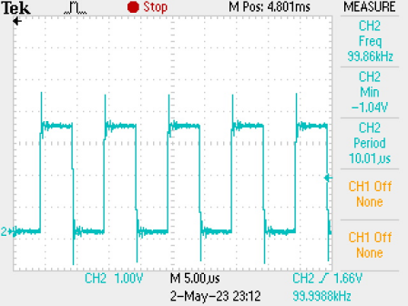

I think you are pushing a nano
using an Arduino Due I can generate 40KHz squarewave
// Arduino Due timer interrupt
//  generate frequency square wave generator on pin 13
#include <DueTimer.h>
// here is the ISR executed by the CPU when the corresponding interrupt occurs
void timerInterrupt()
 digitalWrite(LED_BUILTIN, !digitalRead(LED_BUILTIN));   // invert the signal
  // initialize digital pin LED_BUILTIN as an output.
  pinMode(LED_BUILTIN, OUTPUT);
  Serial.println("\n\nSquarewave on pin");
  Serial.println(LED_BUILTIN);
  Serial.setTimeout(60*60*1000ul);
  // generate 1KHz square wave
  Timer1.attachInterrupt( timerInterrupt).start(500); delay(50);
  readFrequency();
// read frequency to generate
void readFrequency(void)
  Serial.print("frequency Hz ? ");
  long frequency = Serial.parseInt();
  Serial.println(frequency);
  long period= 1000000/(frequency*2);
  Serial.print("\nperiod MicroSeconds = ");
  Serial.println(period);
  while(Serial.available())Serial.read();  // flush input buffer
  Timer1.start(period);                    // setup timer period
// if serial input read next frequency
  if(Serial.available())
    readFrequency();
serial monitor output
Squarewave on pin
13
frequency Hz ? 40000
period MicroSeconds = 12
frequency Hz ? 100000
period MicroSeconds = 5
40KHz square wave
100KHz square wave

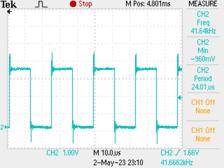

Thank you for both of your replies, they are very helpful. It looks like I may be needing to get some new hardware then (either function generators or a Due!).
I was able to get a 40kHz signal from the Nano, but my limit was 56 kHz (just switching between high and low, not including the array). It's very promising that you were able to achieve 100kHz from the Due.
I know from the paper referenced above that phase control is possible for two signals, but I would need to control 12 signal independently. This may be a bit beyond this scope, but do you think this would be possible? I might need to somehow link multiple Arduinos.
I'm just adding the code included in the open source paper for reference, all credit goes to Asier Marzo and their coworkers. I don't really understand it but it looks like they experimented for a long time to get the number of clock cycles to wait for each step in order to produce the various signals:
