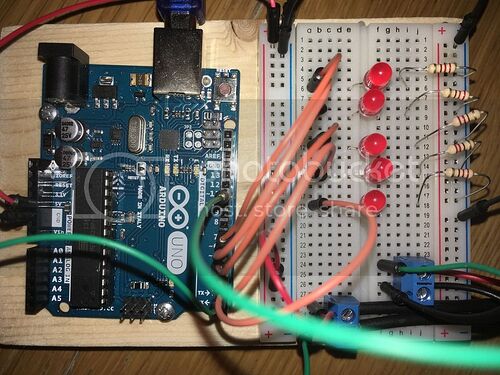

I have written a very simple count down programme to let my son start races with his Scalextric. The programme seems to work fine and is activated with a button. The issue is that after it has run though its script is sometime randomly restarts, sometimes in a continues loop or at with quiet periods.
I am assuming that the random nature points to hardware and removing the switch helps but doesn't cure but any advice would be amazing...
Thank you

Could it be this?
delay(random(2500, 7000));
Oh, try using the code tag button "</>" for posing your code so it looks like above.
