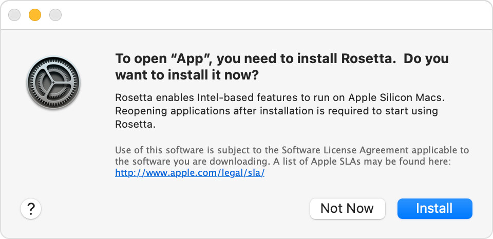

When a user who doesn't already have Rosetta 2 installed starts an "Intel" application directly, macOS displays a friendly dialog explaining the situation and offering to install:
However, in this case where the "Intel" application (g++) is being invoked indirectly via Arduino IDE, macOS doesn't show that dialog and instead only produces this cryptic "bad CPU type in executable" error message. It would be nice if Apple provided a way for the user to trigger the installation of Rosetta 2 via the GUI, but it seems they assume that their "automagical" system will take care of everything, and didn't consider this specific use case.

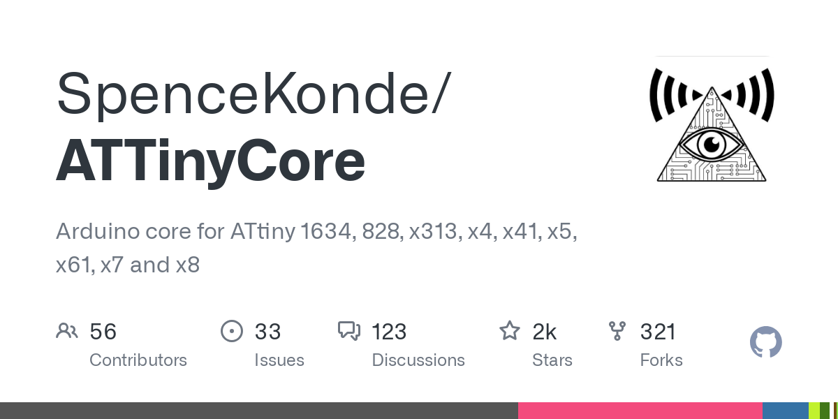

The "Digistump" boards platform has not been maintained for many years and is no longer functional. You should use the reasonably well maintained ATTinyCore boards platform instead, which also provides support for the Digispark board:
There is currently a problem with the drazzy.com website, so instead of following the installation instructions from the ATTinyCore documentation, use these alternative instructions instead:

Thank you for your help the problem now seems to be solved. My configuration is:
Configuration seems to work well when uploading test programmes to the Digispark Rev3 Attiny85
