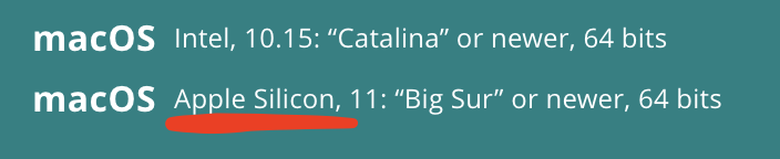

Of course, you could also download the Apple-specific version that will run faster.
