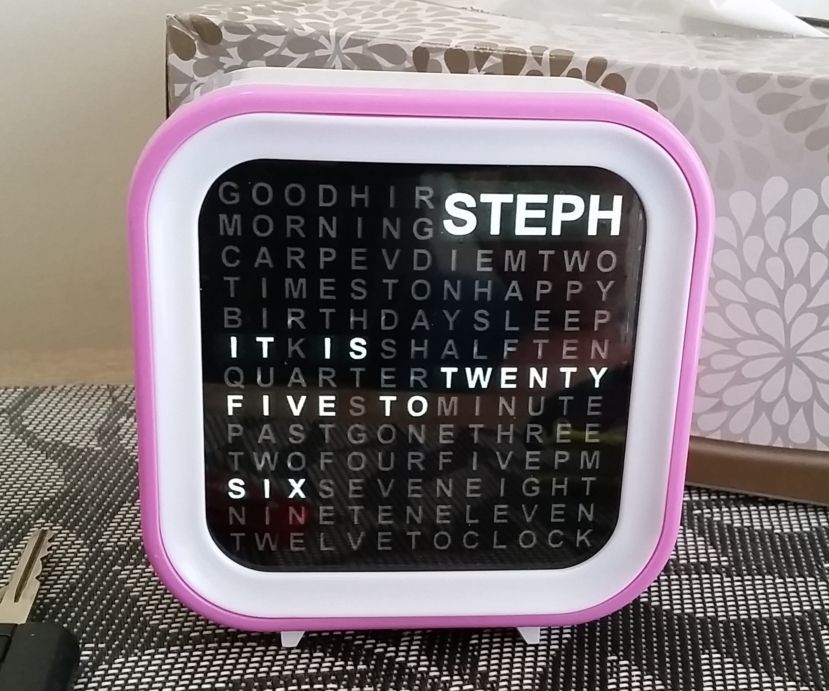

Hold on..... I just looked at your instructable link.
Are you wanting a World clock or a Word clock?
Well noticed! hahaha :smiley: I had no idea it was a word clock.
Anyways, it is meant to be placed in a room, and not switched form that time zone. So daylight saving features would come in handy, but are not a top priority
stef_an:
Word vs World is very different. :wink:

I built a word clock for my mother a couple of years ago.
It was a massive amount of work, with most of the work being the mechanical design since I was using individual LEDs.
