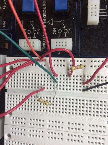

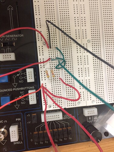

I attached some pictures of the circuit. It may be difficult to follow.. but essentially this is how its wired:
SDA connection point is wired to A5 on arduino Board
SCL connection point is wired to A4 on arduino board.
A (pin 8 ) & Vdd (pin 2) are wired to the 5 volts from the arduino board.
Ground (pin 3), B (pin7) and AD0 (pin 6) are wired to ground on the arduino board.
W (Pin 1) is wired to 1k resistor which is then in series with the LED which then connects to ground.
Side note: when I check the resistance across W right before the resistor as it is coming from the evaluation board) and A I get a resistance of about 4.00 Mohms. If this is acting like a normal potentiometer shouldn't I be getting some resistance value in the range of the total resistance of the chip? It seems way too high.

It is hard to see the over all picture in those pictures. Image5, is that supposed to be the pull up resistors because if it is then that is not wired as per the diagram you posted.

Reply #12 - you have shorted out the two I2C lines in an attempt to wire up the pull up resistors.
The bit in the red circle is not a join, joins are where their are the dots on a crossing of two wires.

It's not strange when you consider you had the wrong address, the I2C lines were swapped and on top of that they were shorted. (FYI)
WRONG (I did say check these pins )
I did a continuity check on the pins to make sure I have the right pin out. Do you think this could be part of the issue?
Which pins did you do the continuity check on ?
Where did you get the pinout you used for the continuity check ?
I2C PINS
UNO PINOUT
I specifically said to check the I2C pins.'
YOURS ARE SWAPPED (SEE THE LINKS POSTED above)

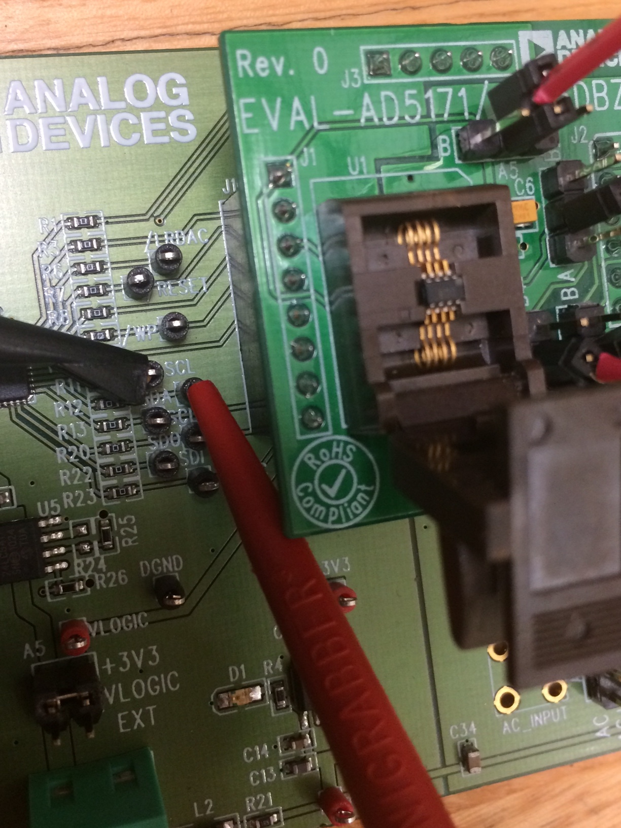

I updated the circuit to fix the short. I attached a picture of the update, one of a general overview of the setup and one of the evaluation board where the chip is held.
Still a solid light on & still cant find it with the scanner. I do not have any other I2C devices but I ordered some other digipot's that are I2C and they should be here today to try, particularly the AD 5171.
I tried another string of I2C scanner code in case their was something wrong with the first but it did the same thing. It just said "Scanning.." and nothing came up.
From the picture showing where the chip was held I used a fluke 189 meter and did a continuity check between each of the pins that come off of the chip and found where it correlates (beeps) to a connection on the evaluation board. You can visually see from the overview where they are connected.
From the spec sheet it indicated the dot on the chip identifies Pin 1. Moving down are pins 2,3 & 4. Then starting from the top of the chip on the opposite side of the dot is 8 and moving down are pins 7, 6, 5. At least that is my understanding from the spec sheet.
