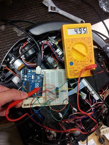

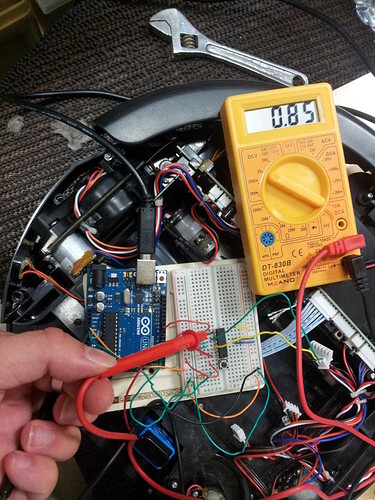

So I've been measuring at some points on the circuit and it seems that the H-bridge is eventually broken :~
I've joined once again some photos of my measurements with the multimeter to be clearer but, as I understand the situation: - 5v power flows through pin 9 of the Arduino, which is suppposed to power pin 1 of the H bridge - 5v power flows through the wire between Arduino's pin 9 and H-bridge's pin 1 - but in the meantime almost no power is measured through pin 1 of the H-bridge.
I haven't enough experience in H-bridges to be sure (it's the first time I use one !), but I think it means it's broken (why would it measure near to zero then ?). :)
I should receive a new h-bridge on Monday, so we'll can figure out if the problem really comes from it (although if it doesn't solve the problem, I'll really be at a loss :sweat_smile: )

Pin 1 one H bridge is the enable pin, or like the H bridge switch, when it gets voltage it starts running.So if you can measure voltage coming out from pin 9 of arduino 1st stage is checked. After what H bridge will do is compare voltage in pin 2 and 7 (they cant be both HIGH or LOW at same time). if pin 2 as voltage and 7 doesnt it will spin in one direction; if 2 doesnt have voltage and 7 does have it will spin in the other direction; if both pins have voltage or if both pins dont have voltage it will not spin at all. So this is your next step,check the voltage on both pins...
Hello, some news about my problem... Yes, I know that if both digital pins for motor control are high or low, it stops the motor. So I checked the voltage of motor pins 1 and 2 on the Arduino and eventually the values are right : 0 for, say, motorpin1 if it's LOW, and 5v on the other, which is HIGH.
What I've found quite funny is that I measured the pins on the Hbridge and I had some surprises. For example I expected to find 0v and 5v on to the pins related to the Arduino's motorPins respectively LOW and HIGH, but instead, it measures about 1 volt or so on the two pins of the h-bridge connected to the motorPins.
So, to resume I measured: 0.85 volt on the hbridge pin connected to Arduino's enablePin (HIGH so measures 5v) ~1v on the hbridge pin connected to Arduino's motorPin2 which is LOW (so measures 0v and ~1.42v on the hbridge pin connected to Arduino's motorPin1 (HIGH and measures 5v).
Apart from it, the 2 hbridge pins connected to the motor both measure 9v as expected. I don't think so, but are such measurements normal with a h bridge? :~
PS: I measured on the old hbridge, the new one didn't arrive yet.
Hello again,
sorry for the double post, just to say that as soon as I started to use the new H-bridge, everything worked like a charm :)
