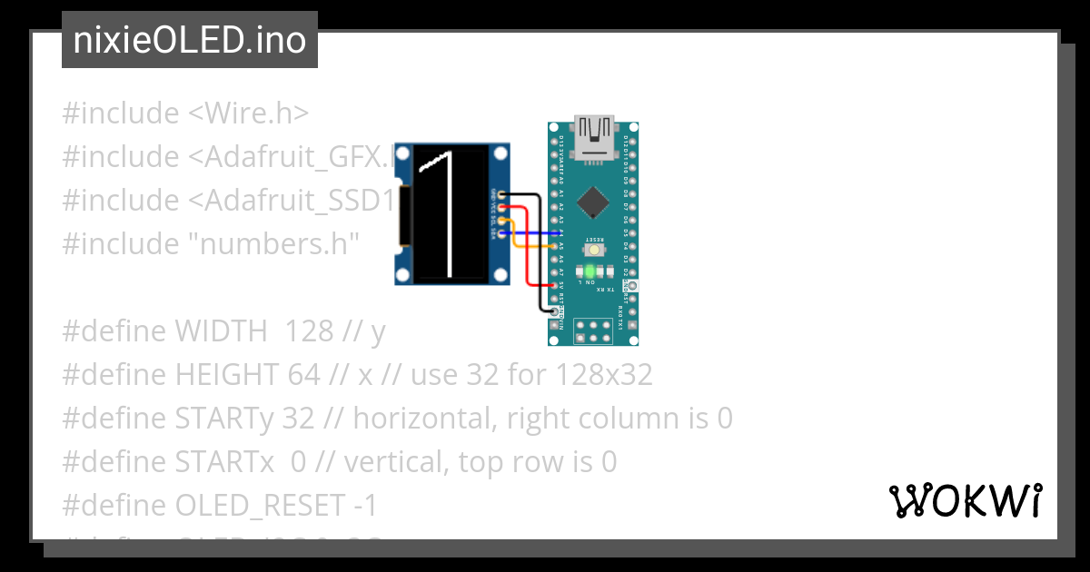

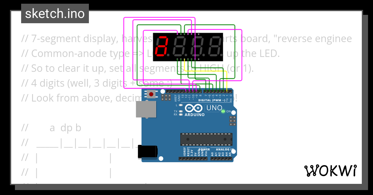

The simulation shows you how to wire up seven segment displays.
It demonstrates doing anything at all with them using plain code.
Surely you have had some kind of experience using buttons, so just add some buttons and make them do what you need.
