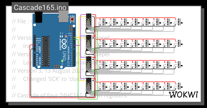

This simulation by @Koepel could be 32 "parking spaces" shown as switches. Use any DPDT (must be HIGH or LOW, not ON or OFF) as a means of parking sensor... then scale it up tenfold.
Unless, of course, the method of detection has been mandated by someone else. It still smells like a classroom exercise (in futility).
Besides, we still don't have an answer about whether it's enough to simply know entries/exits, or if we have to have a map showing which spots are empty, or what.
