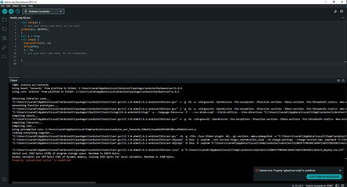

Ok so heres the issue I'm having. I'm trying to upload some code to one of my custom PCB, 32u4 boards. I tried to connect to it with my ATMEL-ICE and burn the Leonardo bootloader onto it. And that failed. So I loaded up Microchip Studio and had Arduino compile a binary of a really basic sketch with boot loader, then I loaded the HEX file threw MC Studio. Worked like a charm, or more precisely, the code loaded and verified.
So I went back to the 2.x IDE and tried to upload the same basic sketch threw the ICE. Sam thing Upload Tool undefined. So I tried it on 1.8X. Similarly a failure. Finally I dropped O-Scope probes on the SPI lines. And I could see that the Arduino IDE wasn't sending anything. MC Studio had bi-directional traffic, so the chip could be talked to but Arduino IDE won't even try.
My best guess is that I messed up some config somewhere while trying to clean out old libraries and board definitions for stuff I don't use anymore. But I have no idea WHAT or how to fix it.

Well so in the 1.8, I have Atmel ICE selected but its still trying to use serial and that's the issue. I don't want to use seral but it keeps trying to use it.
As to the boards clock. I'm trying to run it at 5v. I've used both 8 and 16mhz crystals. And I've tried all sorts of fuse settings. But the root issue is that neither of the IDE's is willing to use the ICE ISP programmer. :frowning: It doesn't send any SPI data and it doesn't toggle the reset pin. Its deffinatly an issue with the IDE not the hardware :frowning:
Just setting the programmer will not magically make de IDE use it. Did you use "upload using programmer" from de menu? Shortcut <ctrl><shift>U.
Ohhhh right that's a thing! I'm so used to using ATTINY UDPI that I forgot thats a thing! I'll try it tonight!
Color me embarrassed.... ty so much! that was what I was forgetting......
