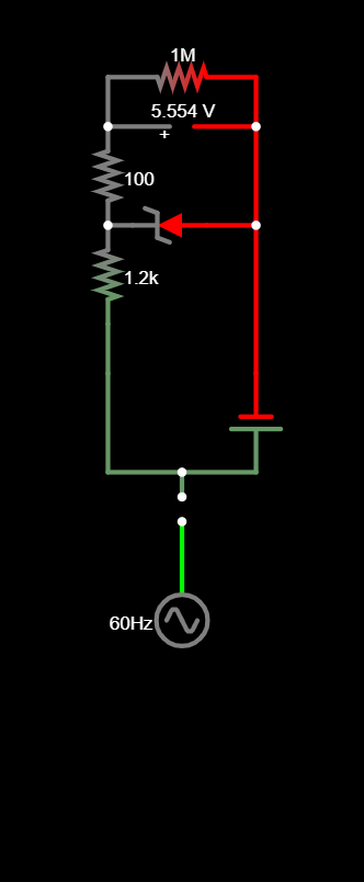

im trying to design a way to prevent over voltage of a 5v analog INPUT. i cant go over 6-7v MAX.
I designed this circuit below. Would this protect ADC IN from the "V2 120v overvoltage"? "D2/Z1.." should clamp at 5.6V and D3 should prevent 120v from going back to the 5v line? i think my resistors being 1/4watt should protect the diode from over current?
Any advice about creating this circuit would be greatly appreciated.
I am a little concerned with D3. I'm not sure what type/value of diode to use. I was thinking about using TVS "P6KE6.8CA-E3/54" Its a 6.8v 600w TVS. but would this work for protecting 120v from travelling back to "V1 5V"?
I dont need the whole 0-5v analog range. i also dont want to cook any resistors..
EDIT: i realize tvs diode i mention is actually bidirectional and most likely wont perform well in that configuration. not sure what to do about protecting V1 from V2
Max pin voltage of a 5volt processor is not 5.6volt, but VCC+0.3volt.
Quite a difference if the processor is unpowered (VCC = 0volt).
Use (Schottky) clamping diodes for pin protection, not zener diodes.

I ran out of time for the simulator i was using, now im using falstad. In this circuit the Zener is 5.6v and the diode is a schottky 200v diode. However it still shows the whole circuit going to -120v ac at 60hz speed.
The ac voltage is set to 120vac. The dc voltage is set to 6.6V the voltmeter dont show any change but the circuit fades red to green when 120vac is connected?

Seems you do not understand how to use them. The Schottkys go from the ADC pin to the Vcc and from the ADC pin to ground so that they conduct whenever the voltage goes 300 mV outside these limits. If the microcontroller is unpowered, then Vcc and ground are the same and the diodes conduct whenever the voltage goes 300 mV above or below ground.
Don't know what "latched" means, but the resistor between the 120 V input and the ADC input will limit the current in the diode, which means that you do not want it to be more than a few mA. 120 V over 10 mA is 12k and 1.2 Watts dissipation in the resistor. Any lower resistance will mean more current (Schottkys will generally take at least 100 mA) and more dissipation in the resistor, so you probably want to use something more like 47k, ½W.
Not at low currents.
The only place where you could use a zener is across the supply of the Arduino, in case the clamping diodes dump more current on the 5volt rail than the Arduino normally draws.
But then I would use a TVS diode (super-zener) with a stand-off of 5volt.

Obviously the current limiting resistor cause a voltage drop when the diode conducts. but wouldn't the schottky still see 120v until it conducts?
Your diagram (post#13) doesn't make sense.
The cathode of the clamping diode on the left goes to Arduino's 5volt supply, not the 120volt supply. That diode prevents getting more than VCC+0.3volt (5.3volt) on the analogue pin.
And what is that 4.986volt doing there. Is it a supply, or the measurement result.
Do you understand that if you put 120volt through any value resistor on the analogue pin, then the voltage on the Arduino pin will always be 5.5volt.
Please use drawing conventions.
Supply on top, ground at the bottom, inputs left, outputs right.
Leo..
Why is this?
Why in this configuration with with ac 60hz 120v wave, do i see 0v on the meter in the sketch?
Basic Ohms law stuff.
An Arduino pin has an extreme high impedance (draws no current).
Zero current through a resistor = no voltage across the resistor (same voltage on the other side).
You can only measure a resistor if you draw current through it (make the sense resistor part of a voltage divider).
