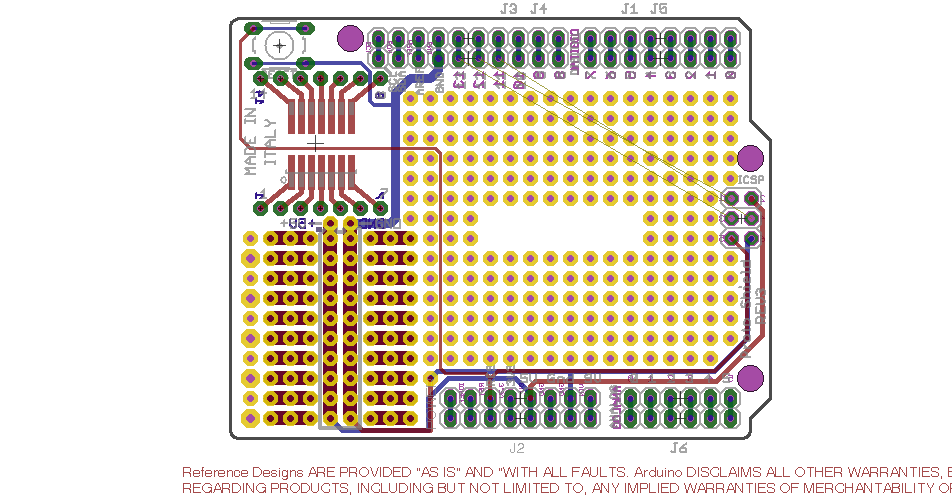

Heyho everyone,
I want to by an Arduino Leonardo and build up my own shields using the ProtoShield. But the ProtoShield schematic shows a connection between the MISO, MOSI and SCK pin of the ICSP header and the I/O-pins 11 to 13, just like the way they are wired on the Uno board. When closely looking at the photographs of the ProtoShield PCB (front, back) I can see that 5V, GND and RST are connected to the ICSP header but I see no connections to the I/O-pins 11, 12 and 13. So is there a connection to these pins? If yes, this connection will render the I/O-Pins 11 to 13 useless on the Leonardo ...
Bye,
Procyon
This is the Protoshield scematic
and it does indeed show the ICSP connector connected as expected.
I can't explain the apparent lack of traces on the pictures. Maybe its a resolution thing.
Heyho,
thanks for pointing out the wrong link.
I looked at the eagle files and the connections between MOSI/MISO/SCK and I/O 11 to 13 are in the layer "unrouted" ... and there is no connection between them in the board layout. So I believe they are not connected on the PCB.
Huh! That is unusual!
Guess they lucked out having that disclaimer underneath.
