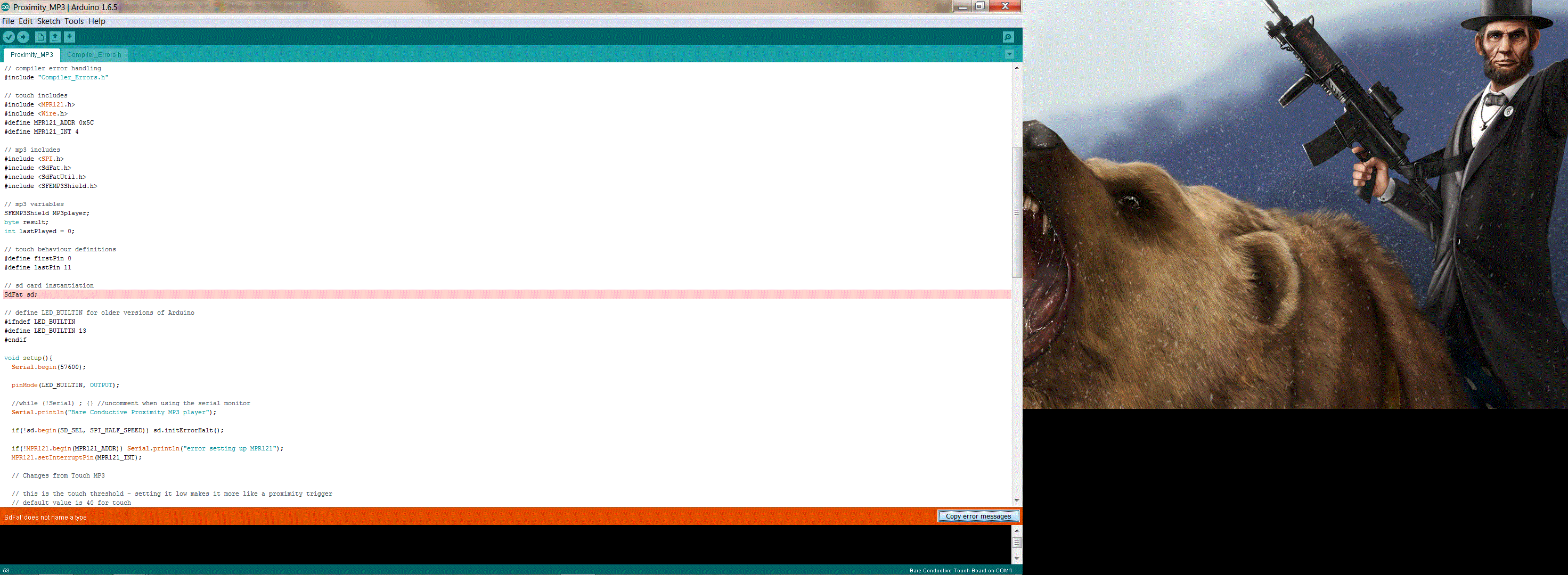

hello there! i recently purchased a bare conductive touch board starter kit and have been slowly figuring my way through very simple tasks. i was intrigued by a proximity sensing tutorial i found here: How To Set Up Proximity Sensing With The Touch Board – Bare Conductive
I followed every step and felt i was making progress. I got to step 3 and hit a wall. It simply says to upload the code. When I go to do so, I am hit with an error message. I have little prior coding knowledge and tried everything I could think to do, along with hours of Googling. The problem occurs in a certain line of the sketch that I believe is defining the SD card. I've read elsewhere that people have used this same sketch and achieved their goal. I have included the error message and a screen shot. I have an Arduino Uno starter kit and a couple of books on the way but I was hoping to continue to learn using this set-up in the meantime. Any help would be greatly appreciated!

And the error message:
Arduino: 1.6.5 (Windows 7), Board: "Bare Conductive Touch Board"
Build options changed, rebuilding all
Using library MPR121 in folder: C:\Program Files (x86)\Arduino\libraries\MPR121 (legacy)
Using library Wire in folder: C:\Program Files (x86)\Arduino\hardware\bare-conductive-arduino-public\avr\libraries\Wire (legacy)
Using library SPI in folder: C:\Program Files (x86)\Arduino\hardware\arduino\avr\libraries\SPI
Using library SdFat.h in folder: C:\Program Files (x86)\Arduino\libraries\SdFat.h (legacy)
Using library SFEMP3Shield in folder: C:\Program Files (x86)\Arduino\libraries\SFEMP3Shield (legacy)
C:\Program Files (x86)\Arduino\hardware\tools\avr/bin/avr-g++ -c -g -Os -w -fno-exceptions -ffunction-sections -fdata-sections -fno-threadsafe-statics -MMD -mmcu=atmega32u4 -DF_CPU=16000000L -DARDUINO=10605 -DARDUINO_AVR_BARETOUCH -DARDUINO_ARCH_AVR -DUSB_VID=0x2A6E -DUSB_PID=0x8003 -DUSB_MANUFACTURER="Bare Conductive" -DUSB_PRODUCT="Touch Board" -IC:\Program Files (x86)\Arduino\hardware\arduino\avr\cores\arduino -IC:\Program Files (x86)\Arduino\hardware\arduino\avr\variants\leonardo -IC:\Program Files (x86)\Arduino\libraries\MPR121 -IC:\Program Files (x86)\Arduino\hardware\bare-conductive-arduino-public\avr\libraries\Wire -IC:\Program Files (x86)\Arduino\hardware\arduino\avr\libraries\SPI -IC:\Program Files (x86)\Arduino\libraries\SdFat.h -IC:\Program Files (x86)\Arduino\libraries\SFEMP3Shield C:\Users\Ethan\AppData\Local\Temp\build4238099441793278476.tmp\Proximity_MP3.cpp -o C:\Users\Ethan\AppData\Local\Temp\build4238099441793278476.tmp\Proximity_MP3.cpp.o
In file included from Proximity_MP3.ino:41:0:
C:\Program Files (x86)\Arduino\libraries\SFEMP3Shield/SFEMP3Shield.h:96:8: error: 'SdFat' does not name a type
extern SdFat sd;
Proximity_MP3.ino:53:1: error: 'SdFat' does not name a type
Proximity_MP3.ino: In function 'void setup()':
Proximity_MP3.ino:68:7: error: 'sd' was not declared in this scope
Thanks again!
Those would be people that had already downloaded and installed the SdFat library properly.
Happy to help. Did you make sure to follow our tutorial on setting up Arduino for the Touch Board? first before uploading the code? One way to confirm that you're on the right track is to open Arduino, then select File>Examples there you should see both MPR121 and SdFat. You should be able to hover on those and then see examples underneath. If not then the folder structure is most likely wrong and I'd go through our tutorial again starting from Step 4.
I did follow a tutorial, it was just the one from Bare. But they didn't have any Sd files that they mentioned. I had moved all of the files that errored when I tried compiling into different folders and was making progress up until this point. I will try a different tutorial later on today. Thanks for your help!
Make sure to check step 9 of the tutorial this is the step where we ask you to install the "SdFat" and "SFEMP3Shield" libraries.
I had followed all of the steps, just had them in the wrong folders. It is now up and running like I was hoping. Attention to details moving forward. Thanks again you've been a big help!
