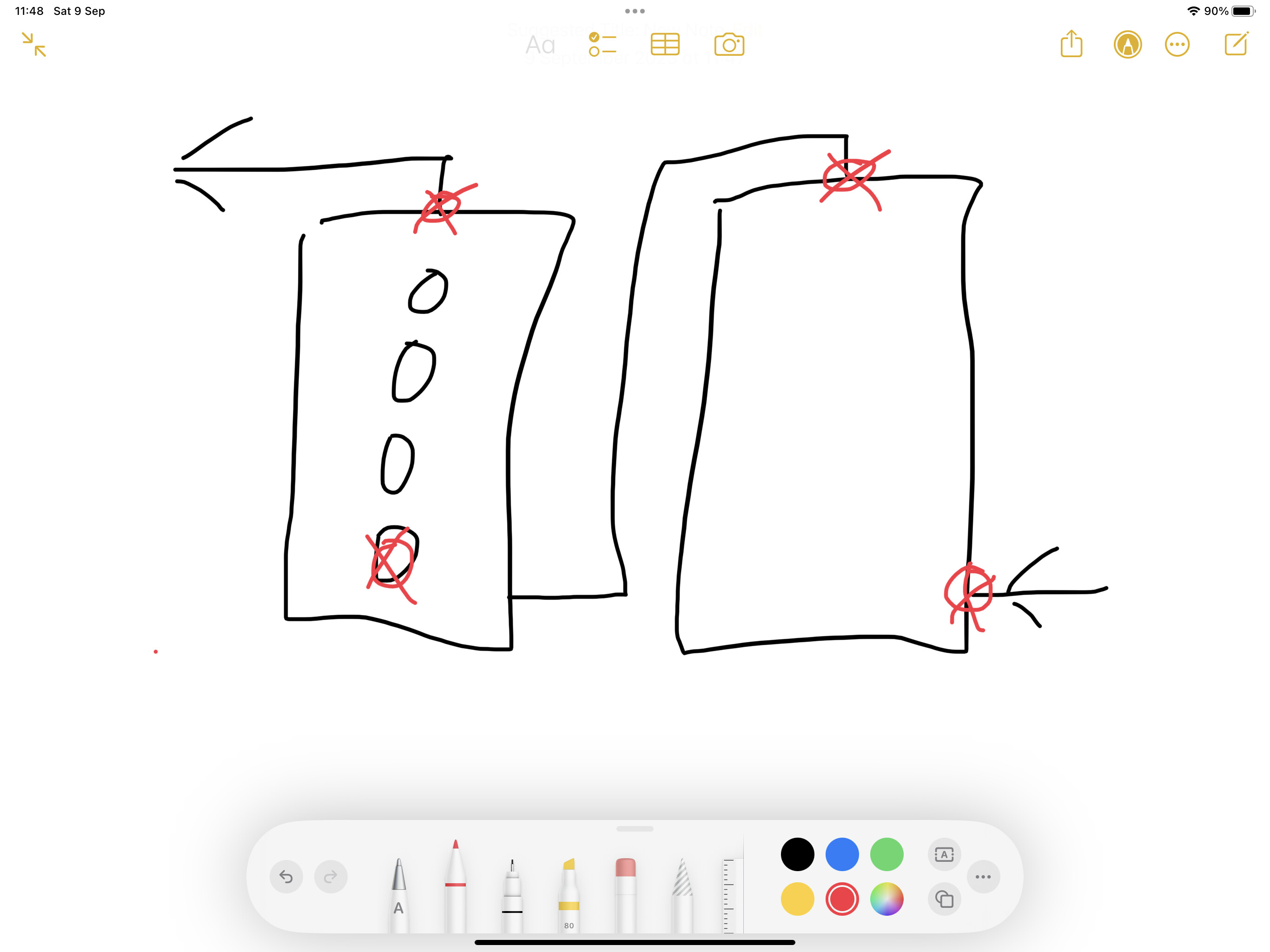

Where the red crosses are are where I propose the pt1000s. There is no software for averaging the sensors in this situation.
Which is which tank, and why two tanks?
Picture of a hand drawn diagram would be better and include more info.

And don’t forget water sits in layers and does not mix unless there is a flow , so the average of a top and bottom temperature is not the average temperature of the water , it can be virtually full of hot water and the bottom will still be cold .( which why the water remains hot until the tank has been emptied of hot water and all replaced with cold).
The layout of the tanks is important - do they thermal syphon between them ? Where is the hot water taken from? . Where is the cold inlet ?
How does the pump circuit work ?
Normally I would expect a three way valve to direct the heat pump output to either tank, controlled by thermostats near the base of the tank .
Your existing PRT maybe to control the outlet temperature of the heat pump.
