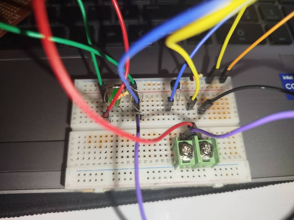

Hi, @kadakisama
Can you post some images of your project?
So we can see your component layout.
Perhaps you wired the transistors incorrectly.

I don't know if you'll be able to see it clearly.

As you can see from that data sheet, the 12V relay has a coil resistance of either 90 or 75 Ohms. The current draw will overheat and/or burn out a BC547 transistor.
It the LED doesn't light, the BC547 is either burned out or miswired.
