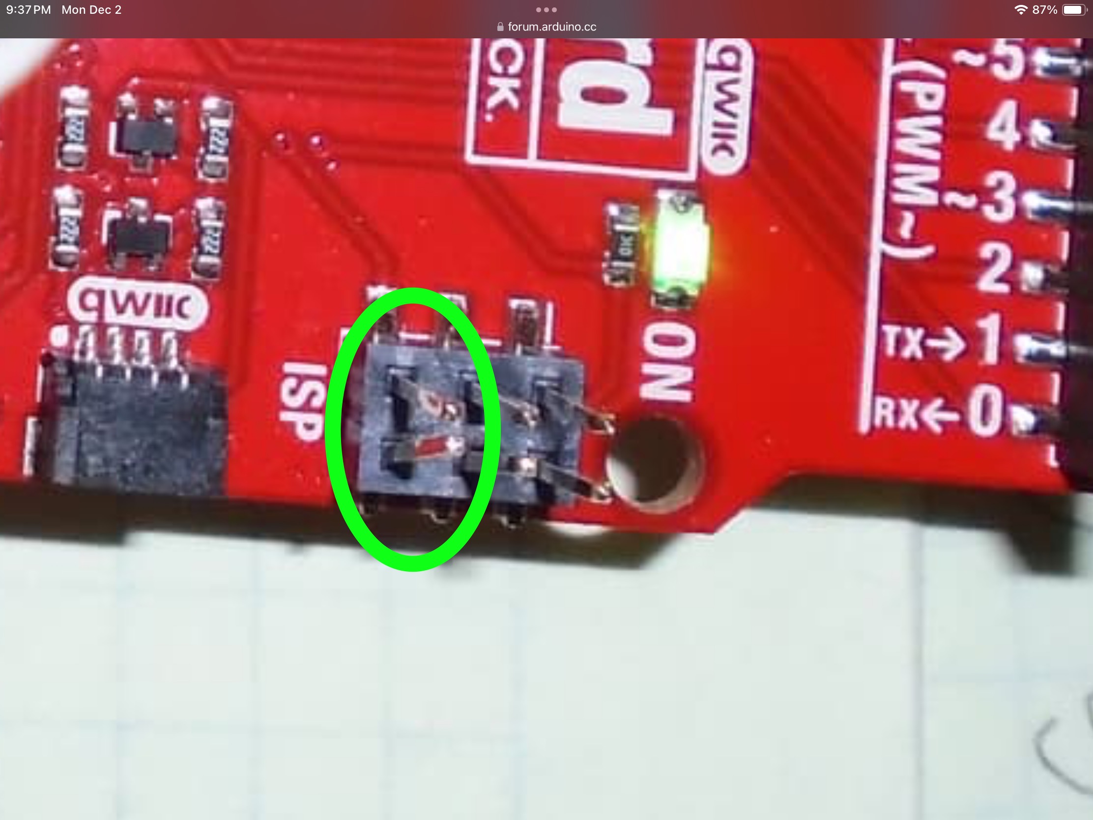

The circuit shows the board powered by power jack (no USB cable connected) so you would not have been able to verify the results via the serial monitor with this exact setup.
  • This is an accident waiting to happen.
Thank you!
The perspective makes it look worse than it actually was, but worth straightening.
I unplugged the cable for the photo. The serial monitor confirmed that the pulldowns worked.

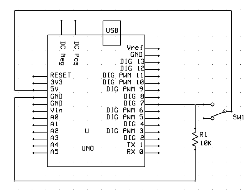

So you have a switch that is either open or connects 5V to the Arduino input pin.
So this is your circuit, basically.
10k should be sufficient.
If the switch is very far away say a metre or more, decreasing 10k to 4k7 and adding a 0.1uF capacitor between the Arduino input and gnd should prevent any noise problems.
