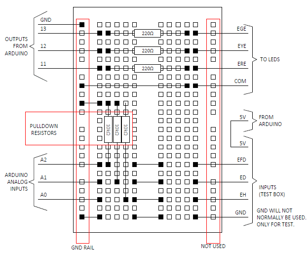

I am creating an application with results based on three inputs. In this situation, I either have a HIGH input or no input. To read this, I am using 10k ohm pulldown resistors. My inputs read as high unless I pull them down to ground.
I was wondering if a smaller value of pulldown resistor might give me LOW value when I remove the HIGH input. Don't tell me to change the sketch to check for LOW instead of HIGH, with this arrangement, the failure mode is important.

Of course it would but why are you considering a smaller value, doesn't the 10K work?
To recap and add info, the switches are only for a test setup. I will be checking inputs from a remote source that is either a voltage or open circuit. In the hope of eliminating an interface relay, I added the pulldown resistors in the hope that they would pull the input to ground when no voltage is present. That did not happen.
They input leads are shielded to prevent picking up stray signals. The test switches are in a steel box as well.
A loss of input due to a broken wire must be treated the same way as no voltage

A 10K should pull an input LOW. If not then you have a wiring error, bad resistors or a value higher than you think.
I'll try to put the circuit here. The code works, this is a circuit and or input problem.
The pulldown resistors all check out, but one of them is a 10% tolerance and reads 11.37kohm.

From your breadboard text: "GND will not normally be used, only for test"
Your don't need a ground connection with opto couplers, but you do with your setup.
Leo..
As I said, I didn't want to create an interface circuit, but I may have to.
The GND connection marked as "not normally used" is for the switches only. That is for future use, but in my testing I used to bring the inputs down when the pulldown resistor would not.
There will be a common for the inputs.
I've been following this but not commented so far. A 10k resistor will easily pull down and Arduino input, so if it's not doing so then something isn't as you think it is or isn't as you have told us.
Start with just a 10k resistor between an input and ground and nothing else. Configure the pin as input, read it and print the result to the serial monitor. Use a piece of wire between the pin and 5V to pull it up, see if it goes high. When that works ok try you larger circuit.

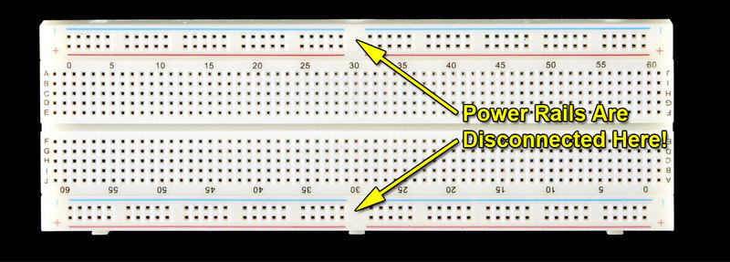

Worth asking if your drawing is of a solderless breadboard that has the notorious "breadboard gap" like this one that needs to have the sections of the rails jumped together?
Edit: I had to fake my picture. @LarryD has a picture of the real thing in post #20
  • I just had to help :wink:
My breadboard has single column
rails. One left and one right. I'm not using the one on the right.
I would perform a simple test to ensure that I could measure continuity between the GND connection of the microcontroller and the end of the resistors that are supposed to be connected to ground and then from the other end of the resistors to the intended microcontroller pins. It doesn't make sense that that is the case on your circuit and that the pins don't read as logical 0.
