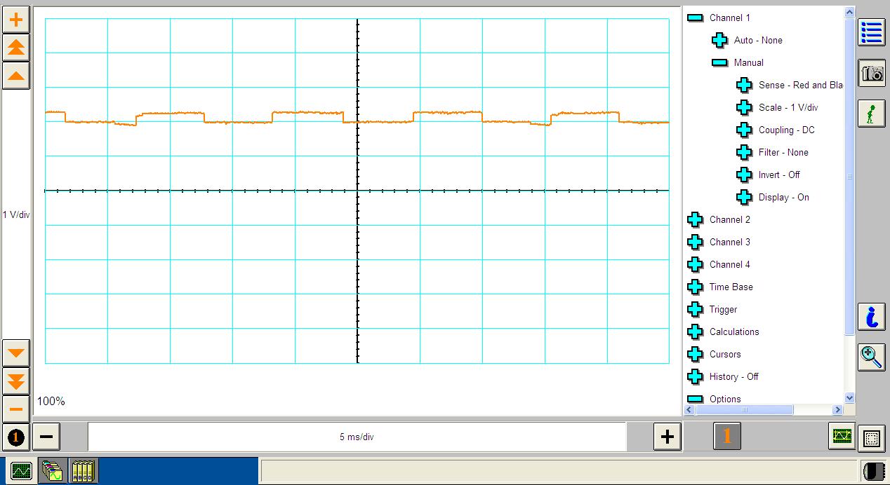

your high of 0.4v is far to low to be seen as a high by the any of the AT chips.
Mark
The signal is, apart from small, AC by the looks of it.

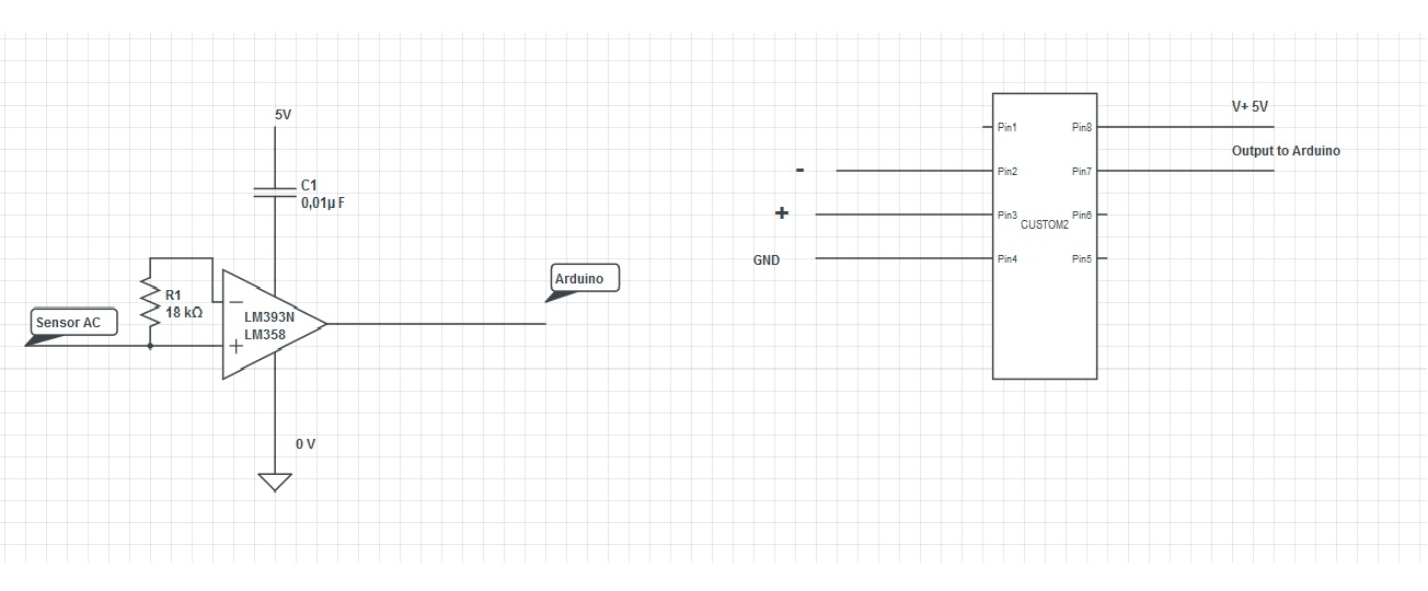

I'm on my way now to the store, just to be sure what you mean, this is how the circuit should look like? And should i just put 5V on V+?
(not that familiar with opamps :confused: )
Also, do you think i best use the output with attachIntterupt and then in to a counter? Or is there a better way to count the pulses per second? Keep in mind that the complete program also handles the pressure sensor and the gyro sensor + writing the data retrieved from them to the SD card...

Comments on your circuit ...
Your -V rail should actually be 0V because the comparator is working on a single rail.
Many op-amp tutorials you will find specify a bi-polar supply +/- because that how all the first op-amps worked, a long tome ago
You need a ground, 0V, on the bottom of your sense resistor so the current has somewhere to go.
The inputs of the op-amp have a huge impedance, so high that you can consider it infinite for 'most' practical purposes.
You are making a current detector ... so you need a current to detect.
The op-amp is in a configuration called open loop which means that it has no feedback circuit to modify the input based on the output.
the result is that a slight positive difference between ' + ' and ' - ' will cause the output to swing all the way to the + rail, your 5V
Swap round the + and - pins, you will find it easier to contextualise.
Don't enable the input pull-up on the Arduino, let the op-amp swing the input high or low.
The output of the op-amp is bipolar so it will pull down, 0V, when low and up when high, 5V. No need for any biasing of the Arduino input.
The result will work like this ...
When the output of the sensor is positive, relative to ground, current will flow through the sense resistor to ground making ' + ' more than ' - ' and the output will be high.
The absolute values of + and - do not matter, this is refereed to as common mode signal, it is the difference that the op-amp reacts to.
When the current is flowing the other way ' - ' will be greater than ' + ' in relative terms, so the output will be low.
Have fun and pleas give me a shout if you run into problems.

I'f I understand correct the circuit should look more like this then? Except for the one difference that the LM393N has a ground pin, so i guess don't need a connection from my sense resistor to ground anymore? I understand it should give either 0V or 5V on the output, and then i can use attachInterrupt() to acknowledge the flank change... Just to be sure of the signal from the sensor output, I emailed an engineer from Ford, he sent me a screenshot from the sensor in 1st gear . I was only able to measure at very low speeds because i had to turn the wheel manually. You can see it below.
Should i connect the ground from the signal also to the opamp, or just the signal wire? I attached the ground from the LM393 to the arduino ground pin.

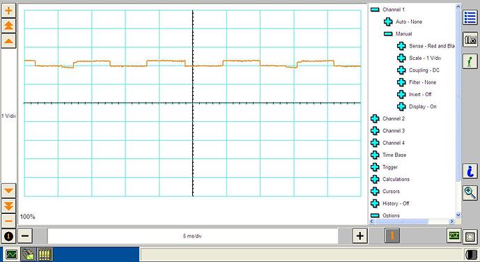

arrr, I thought you said the signal was only 0.4 volts peak. On your image it is showing 1 volt per division and the signal is going between 2 volts and around 2.5 volts.
So, need to work on that.
Also I noticed it before, but that capacitor you have going from the power pin of the op-amp to + v, well change it so that your power + goes to the +Vcc of the op-amp.
The capacitor essentially goes across your supply, that is between 0 volts and 5 volts.
If in fact the signal is like shown on the image, you may need to amplify it somewhat with the op-amp, there may be not enough difference for the comparator to discriminate.
You'll probably need to put in a muti-turn trim pot, that is, a 10 turn trim pot that will allow you some precise adjustment for the comparator to work.
