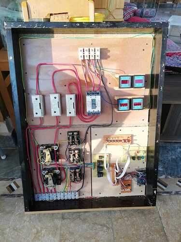

hello,
i have made an automatic generator starter for my home generator and change over.
here is the code and some pics

so here is what i want. i have some leds on each board and i want them to continuously blink while the rest of the program runs.
why they dont work together ?
Your Arduino is blocked from doing anything else during a delay()
Have a look at how millis() is used to manage timing without blocking in Several Things at a Time. It includes some blinking LEDs
And see Using millis() for timing. A beginners guide if you need more explanation.
...R
Another way to blink an LED is to use a timer interrupt. Then it continues to blink even if the rest of the program is in a long blocking loop.
