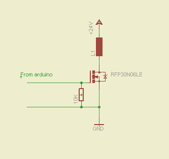

What would be a resonable simple circuit that could take the Arduino outputpin and deliver a 5 maybe up to 10A current to a coil (electromagnet)?
I've tried with a MOSFET (FQP30N06 N-channel, 30A, 60V 0,04mOhm Rds) but it seems only to deliver 2A - somewhere I loose power. The coil has between 2 and 3 Ohms resistance (I have several) I put an extra switch transistor in front to give a higher voltage to the gate (it needs 10V for fully on, if I understand the spec sheet rightly)
It isn't the power supply, that is a large labsupply, and when connecting the coil directly to it, it cheerfully supplies 2-4-8A (whatever I set it's current limit to) and can pulse it, too (I just briefly "clap" the wires) sparks fly and I can see the "magnetic pulse" by the way the pliers jump towards the coil 8)

There are couple questions: when you try to "energize" the coil, what outputs signal you set on digital pin of arduino? I mean: PWM or HIGH ? It possible, that current has no chance to rise due low rate voltage/inductanse? And schematic drawing would be helpful for father investigation.
You've simply used the wrong MOSFET - that one needs 10V gate drive. Logic level MOSFETs have the Ron specified at Vgs=4.5V, not just 10V.
Magician: (1) I mean: PWM or HIGH ? (2)is It possible, that current has no chance to rise due low rate voltage/inductanse? (3) And schematic drawing would be helpful for father investigation.
1:HIGH. Plain DC. Full power, nothing less 8) 2:Possibly, when I do the pulsing. At the moment my measurments use simple DVMs and so I hold the signal for 2-4 seconds (until things get - literally - too warm) enough to see. So the current setup isn't working due to a faulty schematic/circuit. 3:Well, my one isnt any good, so I need a new schematic ;) Rather than load you with my errenous preconception I thought it would be easier if you suggested/sketched one for me. For example, should it be pull down to Gnd or pull up to +ve?

MarkT: that one needs 10V gate drive.
:( But the ones I can find only have 25V and a few A drive if they are "logical FET". So my thought was to put a small switching transistor in front (that also feeds of the +24V) to drag the gate Voltage high enough. But that is the part of the circuit I got wrong (several times). Wrong approach?

But the ones I can find only have 25V and a few A drive if they are “logical FET”. So my thought was to put a small switching transistor in front (that also feeds of the +24V) to drag the gate Voltage high enough. But that is the part of the circuit I got wrong (several times). Wrong approach?
Yes you can drive a higher voltage gate with a transistor but it’s a little complicated because of the three different voltages involves (5V and 24V supplies and 10–12V for the gate).
Perhaps the easiest approach is to drive the gate from a voltage divider from 24V down to 10 to 12V or so, and use a small NPN transistor to short the gate to ground to switch off the FET. Try making the voltage divider thus: 10k from gate to ground, 12k from gate to +24V. This should hold the FET hard on - easy to test.
Then a small NPN transistor - collector to gate, emitter to ground, base via a 10k resistor to Arduino pin. Setting the pin HIGH will make the NPN conduct and bring the MOSFET gate to ground, switching it off. Setting the pin LOW will have the opposite effect. Be careful not to leave the pin as an input and HIGH, as this will turn on the weak-pullup resistors and only partially turn on the NPN.
If you want high frequency switching lower the resistance of the potential divider to, say, 470ohms and 560ohms.
Thanks MarkT, I got a circuit diagram from Magician that is along the same lines.

Just a progress report.
The MOSFET(RFP30N06LE) suggested by Magician works as advertised. :) I get all the power I want in my coil in the very simple circuit : Arduino pin to the gate (a 10k shorts to ground) and oherwise the MOSFET just drains the load to GND, when the pin is set high.
The project (that has been idle for some while) can continue!
I received a PM from “MChus”, asking about the schematic & code. Really, it is that simple, as described in the previous post. Well, being lazy I did buy 3 of these from sparkfun, as it was very convenient with the screw terminals for my prototype. And another 10 of the RFP30N06LE for the actual machine. Note the 10K resistor making sure gate is off when the Arduino is unpowered. I’ll add a flyback diode accross the coil on the next circuit to protect the MOSFET.
