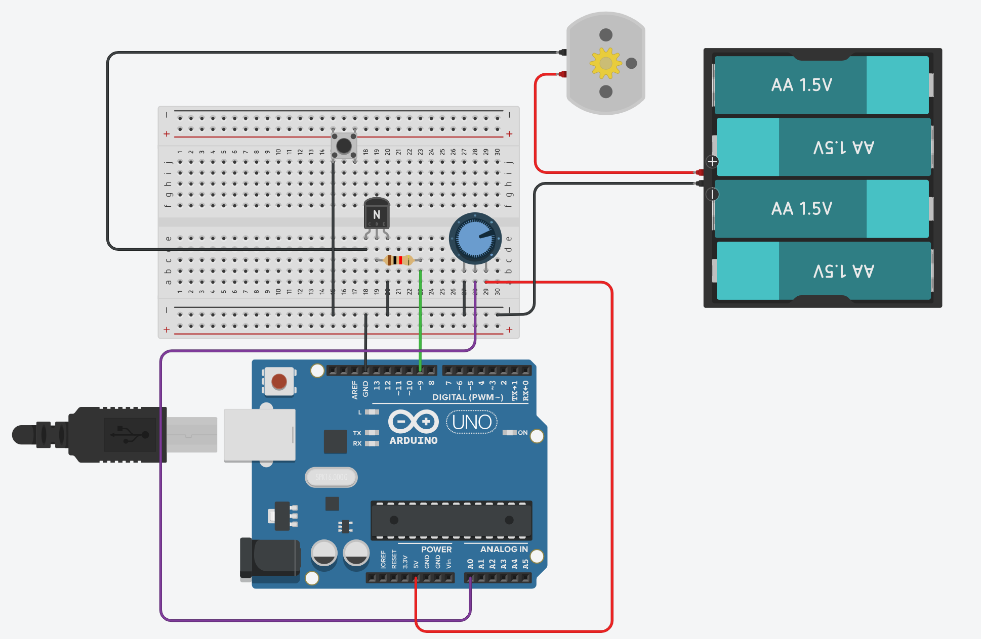

Push Button with actuators
Hi, I need in adding a push button to my project

You want a button which when pressed toggles the motor on/off. The starting state is that the motor is off. Is that correct ?
Which Arduino pin do you want to use for the button and how are you going to wire the button ?

I am occurring with a problem with, what I am doing wrong?

int x = analogRead(A0);
int y = map(x, 0, 1023, 0, 255);
analogWrite(9, y);
state = digitalRead(LEDpin);
if(state == LOW){ // button is pressed digitalWrite(9, HIGH); } else{ // button is not pressed digitalWrite(9, LOW); } }

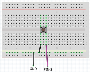

You can start by connecting your switch like this and using <CODE> to post your code.

Try this code and see if the UNO LED turns off/on when you push the button

@jim-p The Uno LED turn on when you press the the button and turn off when you press it again, but the motor is not working.
You need to modify Jim's code, by adding parts from your original code.
