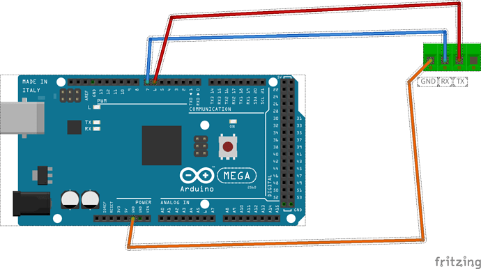

@Robin2 I attached a simple scheme of what I have. On the left the Arduino Mega board where the digital PIN 7 transmits commands to the serial device (this device is a PIC18F8722 microcontroller) and the digital PIN 6 receives the data from the serial device.
Arduino should communicate with the serial device using "frames" of data. In C, the type of data is formatted as int8. As I find out, maybe I'm wrong, that its conversion in Arduino is uint8_t. One example of data frame is this one:

You have on pins 14 to 19 three hardware serial interfaces (labeled TX1/RX1 to TX3/RX3) but you're connecting to pins 6/7? How does that make sense to you?

Please make your image visible in your Post. I already gave you a link to the instructions.

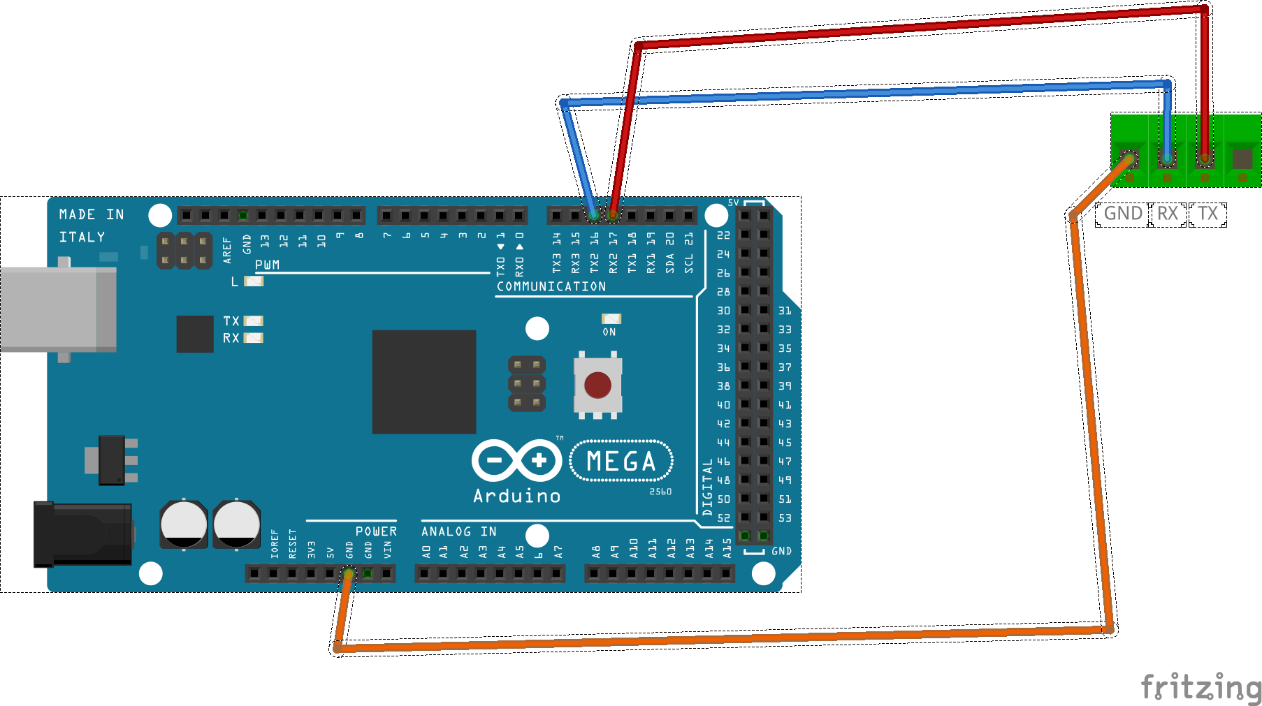

Thank pylon. I didn't know that I had to use exactly those pins to communicate with Serial devices, that why that made sense to me then. I've changed the cables and the pin configuration. However, I'm getting the same result and no information is returned.
@Robin2, find the image as you described.
Any clue?
So you connected the third serial interface (computers count from 0). That means you have to use the Serial2 object instead of the Serial object => Serial2.write() or Serial2.print().
I can't tell from that Fritzing image what pins the wires are connected to. A simple pencil drawing is so much easier to read.
The Mega serial pins have (for example) TX3 and RX3 printed beside the pins that work with Serial3 etc
