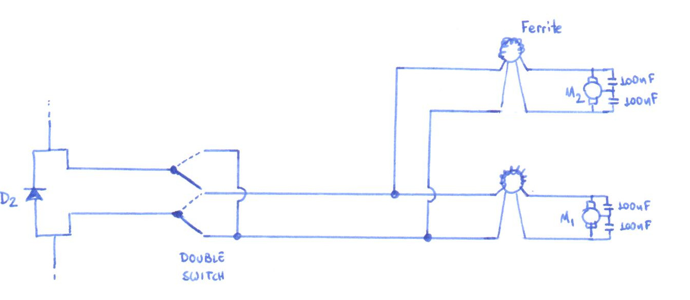

Thank everybody for the suggestions. Indeed the R1/R2 wrongly perform a voltage divider, luckily it was giving always a Vb=.1V<0.6 so the transistor didn't turn on. I moved the R2 on the left of R1 and reduce the R1 to 1k.
Also reducing the R3 to 330 and suppressing the R4 the MOSFET goes high immediately giving a "nice" square pulse. With the R3=10k as it was it had a slow rise of 40us. I have prepared also a 555 as monostable and I will check on the weekend on the kart how it performs and report back here.
