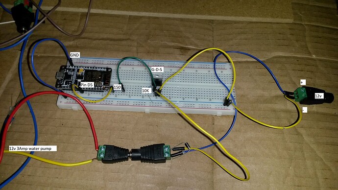

Why am I destroying my MOSFETs?
I've been trying to figure this problem out for ages now and can't see where I'm going wrong.
I've been trying to control the speed of a water pump that runs 12v 3amps at full power. I want to control it by PWM from a NODEMCU and a MOSFET. The MOSFET I'm using is a STP36NF06L N-channel MOSFET.
When I ground or charge the gate without the NODEMCU connected the motor turns off and on fine, but as soon I connect the gate to pin D5 on the NODEMCU the MOSFET overheats and does not work again.
I've destroyed 5 MOSFETs trying to figure this out so now I'm in a blind rage >:( lol.
Change 150 ohm to 2k, 10k to 20K(or remove it), add protecting diode parallel to pomp terminals
Shouldn't that back EMF diode be fully hooked up? Also, it should be as close to the motor as possible.

I had a diode connected to the pump terminals originally but when I couldn't get the thing working I took all the wiring apart to start from scratch. The MOSFET and the resistors aren't correct in the picture I just threw what I had on the breadboard for demo purposes.
Thank you again for your help. I'll be ordering more MOSFETs to do it correctly this time.
UPDATE: As Wawa pointed out, I was off kilter, here. I had forgotten that we're talking about a NODEMCU, here, NOT an Arduino. Thus, the supply voltage [and thus the gate drive voltage] is 3.3V and not 5V. And, the available drive current is 12mA, not 40mA -- huge difference! So, the prevailing indication is that the STP36NF06L MOSFET is just not able to PWM drive that pump, and that a MOSFET more like the one suggested by larsgregersen, the IRL540, which I agree is a better choice, but still might not be enough. This one, maybe: IPP052N06L3GXKSA1, or this one: STP200N3LL These two have rather high input capacitance, but it should still only take 12mA a few hundreds of nS to turn them on, and by the time a couple of volts exist at the Gate, they are already able to handle tens of Amps at their Drain. And, they aren't all that expensive. The edits, below, indicate my errors, and offer insights from my new POV :wink:
The diode was connected originally when I was testing it I just added it to the picture for demo purposes.
But on your advice I will be putting it nearer the motor next time.

That diode looks backward, connect with stripe end to + (blue wire). Switching the motor without the diode (connected correctly) and no heatsink is probably what killed your MOSFETs.
outsider:
I don't think the picture has come out too well. The disconnected side of the diode in the picture was the striped side.
Thank you though for confirming that what I thought was correct was correct. At least I got something right lol
outsider:
...and, actually, after a second look at the photo, it looks like the Cathode side of the Diode is disconnected. But, the diode looks like it's oriented properly.
It's no biggie, but it would be more "correct" to put that 10k resistor on the other side of the 150Ω resistor (i.e. from the Gate to Gnd. The point of the 10k resistor is to insure the Gate returns to ground, should the input to the Gate wind up in a float condition. AND, that resistor can be much higher in value -- more like 100k or even as high as 1MΩ.
ReverseEMF:
I had just rested the diode on the wires for the picture, neither side were connected. It wasn't like that when I was testing... Honest lol. I should have pointed that out in the original post, sorry.
Lesson learnt for next time. Don't be lazy and connect everything as it was when taking a picture :slight_smile:

Change 150 ohm to 2k...
No, dont do that.
150ohm is low enough to ensure fast switching, and high enough to not overload the Arduino pin.
ReverseEMF:
No, that would create a voltage divider that lowers gate drive.
For the gate, it's the same if the bleed resistor is 10000 or 10150 ohm.
10k could be higher, but why. It only draws 333 or 500uA from the pin.
A diode across the pump is needed.
It's drawn correctly, as it shouldn't conduct during normal operation.
Leo..

Actually, the "10k" resistor is usually more like 470k. And with it that high, the voltage divider issue is pretty much moot.
