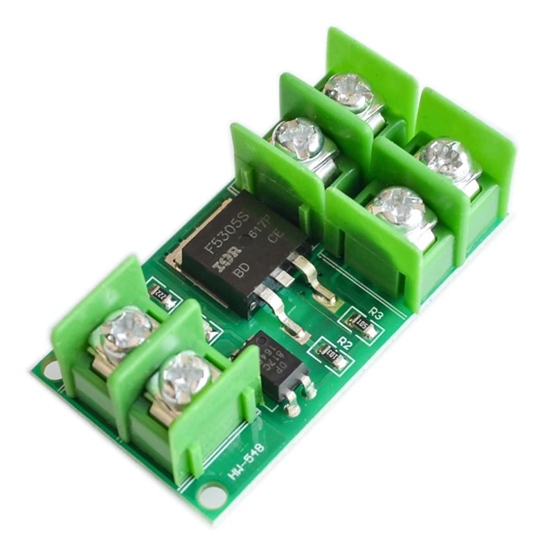

I would like to control the speed of a motor using a PWM MOSFET driver. I’ve got a board based on IRF530:
Here’s a link to the store (it’s in Polish)
I don’t have the right power supply to drive the motor, so just for testing, I’ve connected a regular 12V DC power supply to the DC IN terminals, and a red LED with a 1k resistor to the output terminals. I’ve also connected the board to a PWM and GND pins on Arduino and wrote a code to change the signal from 0 to 100% duty cycle and back. Basically this setup:
The code is working - the status LED on the board is changing its brightness. However, my test LED is constantly ON with full brightness (turns off only when PWM is at 0%) - so it basically behaves like a switch.
What am I doing wrong?

Here’s my code, a photo of the circuit and better photos of the board itself. The labels on the bottom are Chinese, but google translates them to “Power terminal” - that’s where I connected the DC 12V and “Output” - where I have connected the LED.

Do you have an Ohmmeter to find which screw terminal is connected to which MOSFET terminal?
Yes, I checked. - Negatives of the power supply and my LED are connected together - Positive of the power supply goes to the Source (right MOSFET leg) - Positive of my LED is connected to the Drain (top MOSFET pad) - Arduino pin is connected via the optoisolator to 2 resistors on the bottom

I've checked all the connections on board and made a schematic. The transistor turns on and stays on all the time (It's off only when my PWM duty cycle is at 0%), not changing the brightness of my LED.
|500x260
Your schematic shows a P-channel, IRF530 is N-channel.
Weird, the datasheet linked on the board page says it's P-channel https://abc-rc.pl/templates/images/files/995/1512473852-irf5305s-datasheetz.pdf
The part on the board is labeled IRF5305S
Well, that IS weird, we've been barking up the wrong MOSFET! Do you have a 12V supply?

That board will not support PWM. It has a 10k resistor on the gate

That's not a working circuit. You have made a mistake as the gate is permanently clamped at the negative rail and thus the MOSFET must always be fully on.
Also the resistor values are way too high for PWM to be possible - this could explain the behaviour you see.

Here is the overlay provided on the site.

Hi, F5305S is a P-CH MOSFET,

Well from the photo its definitely a 10k and 1M resistor, completely wrong for PWM....
