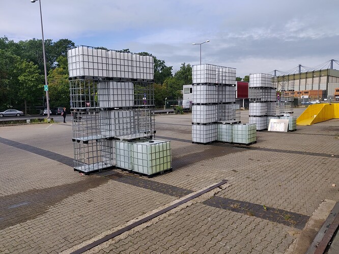

In the final project turnout i want to use multiplexing to adress the 21 Light cubes with 3 Channels each. ... But basics first ;D
I'll attach a picture of the cubes that are to be lit up. (not in the arrangement that they will up, this was just a test stack-up).
