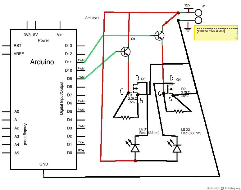

Excuse the crappy schematic, my first time using Fritzing.
Those resistors are in the wrong place as we keep telling you!!!
The resistor should be from the collector to +12V. The gate should go to the collector as well. The emitter should go to ground as should the source.

Hooked it up exactly like the schematic and how yall have said. Still no luck. Going to try a different breadboard, seems I have no luck with breadboards.
Perhaps this will help --
When the Pin is Low, the Gate is High and the FET is On.
When the Pin is High, the Gate is Low (at Gnd) and the FET is Off.
You could look into using a "FET driver" IC, but you should try and get this much right first.
