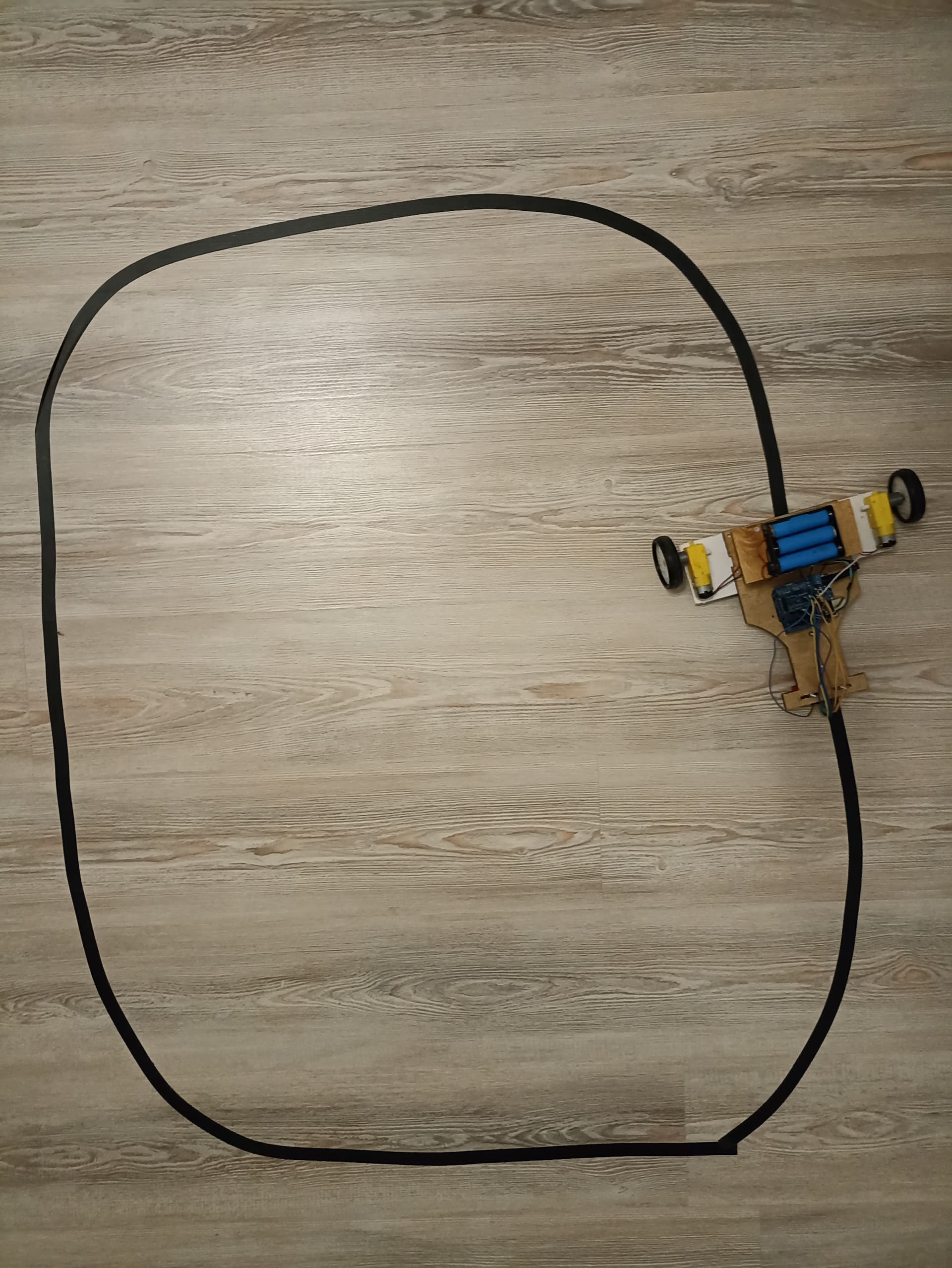

Hello!
I'm making line follower, it has to follow black line on grey wooden background:
problem is, that it follows wooden lines instead of tape
I've seen line follower, that follows tape on brown wooden background.
Here's my code:

thanks for your time
Not enough information.
To debug this problem, first you need to understand how the QTR sensor works, and why it is being deceived.
Start by collecting and analyzing the printout of sensor values for several cases where the black line is present, or not, and the corresponding value returned as "position" from the readLineBlack function.
ok, then I'll collect data. Keep you up to date.
@jremington thanks for respond
  1. I've noticed my last pin IR wasn't working, do PWM pins anyhow interfere with analog pins on UNO R3 (ch340 chipset), if yes I've connected one of my motor pins to PWM on 5th pin. Whatever, I just removed it from code.
  2. IR input on more greyer background 240, less greyer background 100 and tape is 900
  3. Should I create my own algorithm to calculate position with threshold for "more greyer" background?
Still not enough information.
Please post a complete schematic diagram of the wiring, with all pins, parts and connections clearly labeled. Hand drawn is preferred.
For posting instructions, see "How to get the best out of this forum" post, linked at the head of every forum category.
