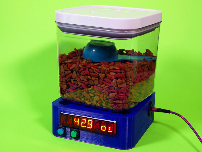

Hello, I am working a project to make a scale using a strain sensor.
I have everything connected, soldered as outlined in the guide but the displays do not display as expected. They just display nonsense.
Is there another library I need to use for these displays. Does anyone have any ideas?

The displays are I2C, connected to the same controller. They have the same data on them (displaying the same thing). Have you checked their address?
Alphanumeric Display I2C Jumpers
    Alphanumeric display 1 (on the left): A0, A1 and A2 open (0x70)
    Alphanumeric display 2 (on the right): A0 closed, A1 and A2 open (0x71)
Thanks, Yes I am getting all the correct addresses after soldering A0,
I think that I might be missing software.
The Sparkfun Displays are not the exact same the displays in the project.
These are my current imports
